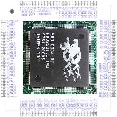

From the schematic information which lists full pinouts for both the 3Dfx 500-0004-02 TMU and 3Dfx 500-0003-03 FBI, I've put together an initial pinout for the TMU which matches up very well with what I see on the PCB:
The attachment 3DFX_500-0004-02_TMU.png is no longer available
The memory bus is taking up most of the pins on the TMU, it's got a 64-bit wide memory bus dedicated to the TMU, with individual control of all address and data bits for each of the 4x memory chips, only grouping up the RAS pins. I think going by the numbers the memory layout should be like this - here's the other card I'm trying to fix:
The attachment 500-0004-02_TMU_MemLayout.jpg is no longer available
Going from what I've read about the Voodoo 1 going to the Voodoo2, with the V2 mostly getting speed improvements from being a process improved, better optioned version of the Voodoo 1, giving it higher clocks and multitexturing.
I suspect that the TMU chips may have a lot in common beyond just the pin count (208 on V1 and V2) although someone would need to check, specifically the TT_DATA pins would be important to verify first.

As for the V2 TMU, I randomly compared about 30 pins, and they are identical to the
500-0004-02. I'll check all the pins and give an update later today.
Edit: All V2 TMU (500-0010-01) pins are identical to the V1 TMU (500-0004-02). This could prove to be quite interesting...
Regarding the TT bus, you are right.
A V2 looks like this:
FBI to TMU0 and FBI to TMU1 (same nets but the bus is split), this is the FT bus.
TT bus (from TMU1 to TMU0)
FT bus (from TMU0 to FBI).
Basically the TMU outputs are daisy chained back to FBI input.

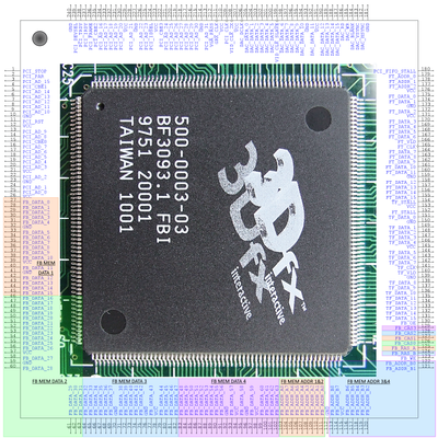

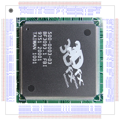

I've now done the same treatment for the 3Dfx 500-0003-03 FBI chip. This one's a bit different in how it addresses memory, there are only two sets of memory addressing pins and the notation for the framebuffer memory data pins doesn't clarify which set of FB_DATA pins goes to which memory chip. So I've clarified the picture with a colour highlight for each memory chip - the boxes with two colours are the pins shared between two memory chips.
Here's the colourised version:
The attachment 3DFX_500-0003-03_FBI-channels.png is no longer available
And the unannotated version:
The attachment 3DFX_500-0003-03_FBI.png is no longer available
They're losslessly compressed this time 😀
Unfortunately this is where the Voodoo 1 differs from the Voodoo2 - the 500-0003-03 FBI chip has 240 pins while the 500-0009-01 CK or 'Chuck' has 256 in total. I do wonder if the pins would be the same up to pin 240 and then they added in some extra pins, or if it's all different.

I compared the pinouts, the V2 FBI has the following extra pins:
- 2 extra RAS lines
- PCI INT pin
- SLI SYNC signals (2x)
- a reset signal that goes to the TMUs (buffered from PCI RST)
- a clock signal that goes to the SLI slave
- a pin for sensing if the card has a monitor plugged in, goes to the RAMDAC which detects the 75R VGA terminations (this is how 1 card becomes the master in an SLI setup).

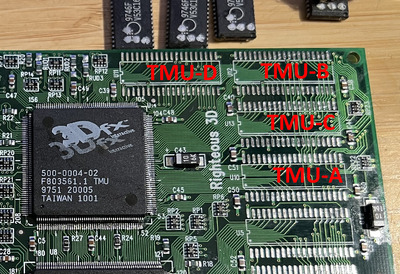

I am trying to figure out why my Orchid Righteous 3D only sees 1MB on the TMU when I can't see any bad pins. I am wondering if perhaps I reconfigured one of the strap resistors - I did most of the work on this faulty card in 2021-ish, before I kept reliable logs of changes I make to each item.
Those additions for SLI / function make sense, as far as I'm aware the 3Dfx FBI chip has little the in way of GPIO type pins to assign extra functions to. Makes Anthony's King Shaman 3Dfx Voodoo 1 card quite impressive at a hardware level 😀

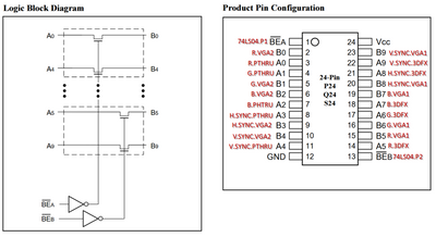

Wow, 18 months ago I forgot I made this picture when I was first troubleshooting my £20 trainwreck Voodoo 1 reference design card:
The attachment 3dfx-reference-design-vgaswitch.png is no longer available
This is from the PI5C-3384Q datasheet since that's one of the first parts I was fixing. Should be the same on most designs that use this small 24-pin chip to switch between the two VGA sources like a KVM 😀
Most Voodoo 1 cards use resistors and resistor packs to connect up the memory data / address / RAS / CAS lines and if you've watched any 3Dfx repair videos you'll know those can be at fault too. I was trying to figure out what caused the black blocks on textures on my reference Voodoo 1 and through chance tracked it to the one resistor pack that connects up TMU memory on this cheaply made card (nicer cards will use resistor packs for everything):

I'm still working on my Orchid Righteous 3D though which will only see 1MB of TMU memory and has bad texture corruption 🙁 That does have resistor packs to check through each point of.
I don't get the TMU chip, the video memory is surely accessed in 16-bit chunks so why does it map the CAS lines to the Upper CAS of chips 1&2, Lower CAS of chips 1&2, then Upper & Lower CAS of chips 3&4 separately. It seems to use the RAS line as a chip / bank select, which is why the Voodoo 1 TMU memory upgrade mod works.

Then I did some probing around this 1997 revision of the Diamond Monster 3D on the FBI chip:
PIN 124 FB_RAS_B > U7 & U8 RAS
PIN 125 FB_RAS_A > U6 & U9 RAS
pin 126 FB_CAS0 > U6 UCAS/LCAS
pin 127 FB_CAS1 > U9 UCAS/LCAS
pin 128 FB_CAS2 > U7 UCAS/LCAS
pin 129 FB_CAS3 > U8 UCAS/LCAS
These all hook to their respective memory chips through two 100 ohm 4-way resistor arrays RP17 and RP18.
Checking the data 0 pin on each memory chip to see which memory 'block' it hooks to following the diagrams in the previous posts:
U6 = FB_MEM_DATA_1
U9 = FB_MEM_DATA_2
U7 = FB_MEM_DATA_3
U8 = FB_MEM_DATA_4
My understanding is that that means when just 1MB of FBI memory is enabled, U9 & U6 are the two in use as the 1st Megabyte of memory with MEM_DATA_1 & 2. Making it 32 bits wide and a separate bank from the 3 & 4 section.
I know that all the pins are attached on the corner of the chip with the mem data 3 & 4 pins and looked at the memory instead, all the SOJ EDO memory chips have bash marks all over them, could they be damaged?
To test that I just put flux and a load of fresh solder over all the pins of U7 & U8 to make sure they're all soldered properly. This card's taken enough knocks that some solder may have fractured.
And that was it, resoldering those two chips (shown in the grabber picture) fixed it and now the card works 100% in Tomb Raider and Unreal. Another one fixed 😀

If anyone knows how to troubleshoot noisy / jittery VGA output on a Voodoo 1 / 2 please let me know 😀
If the noisе (vertical interference) is only in 3D, you can press the auto-adjust button on the LCD monitor.
If the jitter is in 2D, you may need to replace the 3384Q bus switch.
Voodoo1 with Pentium 800 and faster can give vertical lines jitter, up to image crash.

If the noisе (vertical interference) is only in 3D, you can press the auto-adjust button on the LCD monitor. If the jitter is in […]
Thermalwrong wrote on 2023-12-07, 00:07:
For most of my testing I use a K6-2 450 so it's definitely not too quick 😀
I've tried adjusting phase and stuff to no avail.
The two cards I'm having trouble with, one had damage to the bus switch but the other was just missing some of the FBx components, I'd thought the common factor was the TVP3408. But now I'm kind of seeing that the common factor is both cards had random inductors put in place of the original ferrite beads.
I'm putting in an order for some correct parts for Mouser and will try that out when they get here.

Have you come across a faulty TMU chip and do you know where it might be possible to source one for a Voodoo 1? In the first post you can see an Orchid Righteous 3D with all its RAM removed and that one I have failed over and over to fix. Swapped the RAM around and the fault remains with the TMU which just sees 1MB of RAM and there are unmoving black spots on textures in a grid pattern in tomb raider for instance.
Yesterday I verified that every single pin (RAS, CAS, Addr, Data) on all 4 chips was hooked up and every one read with the proper value, data lines having 0 ohms resistance and the address & RAS/CAS/etc going through 33 ohm resistors.
I know from when I got it that the seller said it failed in use and when testing it the TMU does get really hot, moreso than most Voodoo 1 cards I've come across, I'm thinking a bond wire has broken in the chip?

I don't know if anyone else has found this but it seems to me that the pre '98 TMU and FBI chips run REALLY hot, here are some examples:
