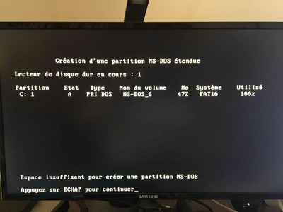

Hello. I have a 6Gb hard drive and I used it to install DOS 6.2. During the install process, I chose to create and use a principal DOS FAT 16 partition with max size and the max I could choose was 472 Mb. That leaves a lot of empty space on the HDD. I wanted to use this empty space to create a 2nd partition and store files but FDISK won't give me the option to create it. When I try to create an extended partition, FDISK says there is not enough space. I tried to use a couple of other partition manager software (not so many available running under DOS...), but I can't fix this issue. It seems that the capacity of my HDD has been permanently reduced to 472 Mb. Any idea? Thanks.

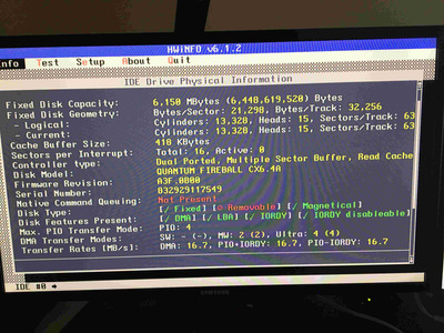

Reply 2 of 12, by Choux69
Thanks for the reply. Yes the full HDD capacity is detected by the BIOS. See the clip screen of HWINFO. I also added the clip screen of FDISK when I attempt to create an extended partition.

Reply 5 of 12, by weedeewee
The HWINFO utility seems to,i'm assuming, just read the data directly off of the harddrive. Which in this case will be utterly useless. Sometimes useful, sometimes annoying utilities. (I think the author is also on this board 😉 )
What matters at this point is how your BIOS sees the harddrive. So, press del to enter your bios or whatever key you need to press and verify how the drive is set up in the BIOS.
