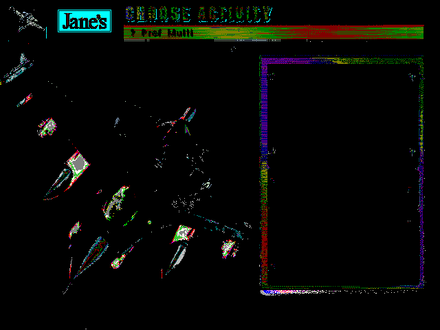

Reply 6 of 16, by PCG98
I see what I missed- I used the "run" function from ACT and then linked the ATF Gold exe.
That's an improvement, but the graphics are still messed up. I have them set to 1024x768 and all terrain is set to best quality. In gameplay, the sky is correct, but the land & water are funky- mostly the water.
I've attached a screen shot for the title page, it actually looks a lot better, not any black, but the quality is like it is 256 color or less.
The other pic is from gameplay, ditto the black not being there (it is proper sky), but this gives an idea of what the water looks like.
    76.55 KiB
    No downloads
    Screenshot from gameplay showing water
    18.85 KiB
    2830 views
    Screenshot for main screen
Reply 7 of 16, by filipetolhuizen
Then you need this as well. You just need to apply the fix once and the colour problems will be solved.
You don't need to run ATF inside ACT. Just installing the database inside should fix it everytime you run it. You'll have to disable Win98 compat. mode for the .exe too.
