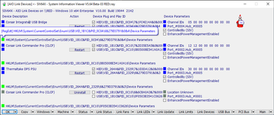

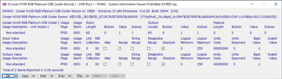

Exactly which AIO is it and do you run any software that interacts with it?
One thing that you could try is to disable EnhancedPowerManagementEnabled then restart the device. On this system it's in HKLM\System\CurrentControlSet\Enum\USB\VID_1B1C&PID_0C04\6&279D3791&0&4\Device Parameters and yours will be almost the same, but 6&279D3791&0&4 will be different.
You could use the Menu->Tools->Link Devices panel of my SIV utility, uncheck the EnhancedPowerManagementEnabled then press [ Restart ]

    ✅EnhancedPowerManagementEnabled

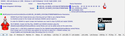

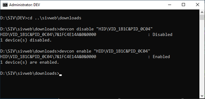

Yes, the H110i protocol is such that you need to do write + read + write + read, as each read needs to be preceded by a write then a lock needs to be used to ensure such as write + write + read + read don't happen when two programs try to access the device at the same time. See https://siv.boards.net/thread/14/running-same … me-corsair-icue
As EnhancedPowerManagementEnabled is disabled/unchecked it can't be that which is causing the issue. I suspect the Corsair stuff must have disabled it.
BEEN_Nath_58 wrote on 2022-04-04, 05:15:
I am just here to comment that C-Media headphones prevent NFS1 from launching and I'll be following this thread.
Given this I suspect that the Lithtech engine is accessing HID devices that it should not be accessing and needs to be fixed. Given this probably can't be done then you could disable the AIO using device manager before you start the game and enable it once the game has started. It's also possible to disable and enable it using the devcon command, see https://stackoverflow.com/questions/47530182/ … om-command-line
I don't think devcon.exe is there by default on W10 or W11 as it's part of the Windows WDK so I have attached it. I suspect the commands to use for the H110i are devcon disable "HID\VID_1B1C&PID_0C04" and devcon enable "HID\VID_1B1C&PID_0C04"

    It worked for me
    devcon.exe
    80 KiB
    57 downloads

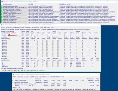

Without knowing why it's accessing the Corsair AIO it's hard to know where to start. I guess it could be scanning for HID Game controllers and the AIO get's confused, but this does not made sense as there is the Joystick API that should be used. It's also quite easy to get HID to tell you if it's a joystick before you directly access it.
Is there a configuration option to get it to skip specified Device IDs? Of so then try adding HID\VID_1B1C&PID_0C04.

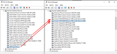

I wasn't aware that the Corsair stuff even appears in the device manager?
They will only appear in Device Manager when the USB cable is connected and even then the default names mean it's tricky to spot them.
Several years ago this annoyed me once too often so I got SIV to automatically set meaningful names when -AIOCTL is specified. Pressing [Restart] on [Link Devices] will also set the meaningful names.

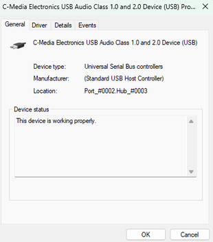

It has been quite sometime, and I just tested it today. Let's just clear some confusion, NFSSE isn't a Lithtech game. Having said that...
Using the SIV tool, I collected the ID and disabled the USB device for the of my C-media headphone (instead of HID device), but then I disabled the HID device too. The app started working.
Then I went back to enable both HID and USB devices. Turns out, the problem is not the HID but USB device instead. And I would need the USB device to listen to what sound the game is playing. So is there any idea what to do, the game works fine with any other sound device.
Another help, I clicked on the blue buttons on the left side of a hardware and now the device name has been changed. Is there a recovery method for the device name (doesn't matter much but still...)
As I said before I suspect the game will need to be fixed.

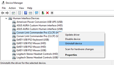

After setting the name an easy way to revert is to use Windows Device Manager to uninstall the HID then USB devices and then do Scan for hardware changes.

I couldn't follow you.
file.php?mode=view&id=155296
I think this device was named "USB Audio Device". How do I recover that name?

BEEN_Nath_58 wrote on 2023-01-18, 08:48:
Uninstall and Remove are much the same.
file.php?id=155297
