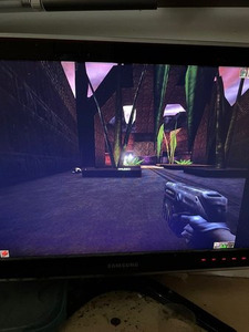

Reply 2 of 12, by predator_085
the brighter one is the nglide. the darker one is the direct3d.

Unreal always looked better in Glide mode than using the stock Direct3D and especially OpenGL renderers. IIRC, OpenGL wasn't even fully supported and you had to enable it manually.
If you want to play Unreal on a modern system with the correct visuals, I suggest using the OldUnreal fan made patch.

Not even that! Voodoo Graphics is what GlideDrv was originally made for. The optimizations done for the Voodoo2 are when the visual regressions start with multitexturing darkening the game considerably to Quake2-amounts of dark (later patches shift the lightmaps up with a clamp so it's GLQuake-ish levels of scale). Voodoo3 was the same deal but now with no opportunity to use the earlier versions. The Banshee probably offers a visually better Unreal experience than the V2/V3.
Canonically, SoftDrv's the driver Unreal's developed on for most of its time, and that had overbrights which Glidedrv -sort of had (not on models)- before multitexturing. D3DDrv, SGLDrv and OpenGLDrv try to do some texture load compensations to attempt matching SoftDrv's lighting scale. GlideDrv had hardware gamma.
D3DDrv also puts more detail texture layers on so the fill isn't identical to GlideDrv and anyone doing '3dfx vs everyone else!!! 3dfx rulez' benchmark with that is up for misleading.
