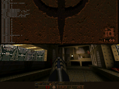

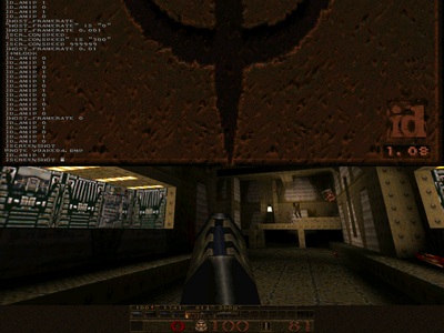

Reply 362 of 2962, by RaVeN-05
my friend discovered one of two undocumented vquake console cvars:
d_amip 1/0 (default 1) 1-use mipmaps on models, 0-dont use which is better quality .
d_sync 1/0 (default 1) - still unknown , maybe its vsync , seems nothing changes.

RaVeN-05 wrote on 2023-11-15, 18:50:
Nice. I can't see a difference in those two screenshots at 640x480.

click on screenshoots to load larger image, look as head and body at distance
