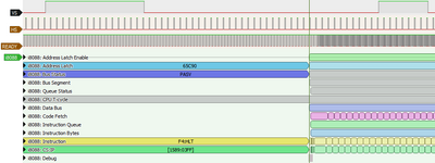

In my course of investigating my bus capture of Area 5150's "Lake" end credits effect, I discovered something interesting.
The effect goes through a chain of interrupts that set up a vsync interrupt that triggers each frame of the effect. The purpose of the chain is to position the interrupt at a specific point on screen that isn't strictly at display enable or some other easily pollable location. I've noticed that despite my best efforts I seem to have a bit of inaccuracy with where MartyPC comes out of the interrupt chain vs where hardware does.
The bus sniffer shows something quite interesting:
44 KiB
869 views
half vsync analyzer
On the Motorola 6845 CRTC a vsync is always 16 scanlines tall. That's sort of taken for gospel; the Amstrad CPC compendium just states it several times. And yet, here we have an 8 scanline vsync.
This is taken right off the CRTC's VS pin, so we're not dealing with any of IBM's shenanigans.
Moreover, there's no indication on the CRTC that a vsync should be appearing here. Looks like a case of phantom vsync.
VileR put together a nice article on the subject here: https://int10h.org/blog/2023/03/cga-6845-crtc … m-vsync-glitch/
there's just one problem - vsyncs, phantom or not, are always 16 scanlines, tall, aren't they?

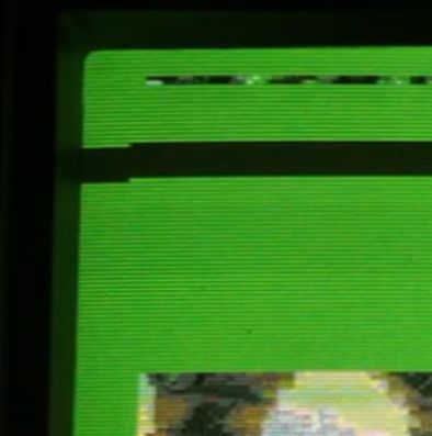

I went back to VileR's capture of Area 5150 on youtube, and by some miracle, wouldnt you know, at 8:26 ...
96.59 KiB
869 views
half vsync screenshot
there she be. this 'impossible vsync' is, unfortunately included in Area 5150's effect interrupt setup timings. Talk about breaking your emulators...

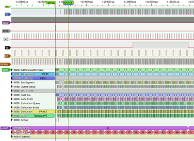

Thanks for the heads-up about this (and a big hats-off for the whole bus-sniffing and visualization setup)!
Here's my hunch about what's going on: the answer probably lies in how the 6845 counts those 16 scanlines. A vsync pulse always seems to start and end 8 hdots before a new scanline begins, which you can see from the screenshot above as well. Most likely, the CRTC simply keeps VS high until HTotal has been reached 16 times, i.e. C0=R0 (see footnote #1 in the "phantom vsync" article). Part of the trickery in this effect is that HTotal is in fact reached twice per *physical* scanline - as far as the CRTC is concerned, 16 scanlines have elapsed, but only 8 for the monitor, so that actually checks out.
(I've also replied as much in the blog comments, but there's no notification on those, so putting this here as well.)
BTW, this one might actually be a "true" vsync rather than a "phantom" one; it just takes a couple of frames for vertical sync to settle at the beginning of the effect, so it's inadvertently visible, but it's placement with respect to the top of the image looks about right.

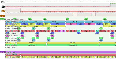

Reply 2 of 9, by GloriousCow
I'm suspicious that it's a phantom vsync for a few reasons - mostly because MartyPC doesn't see any reason to do a vsync at all at that point, and the alternative is I just have a gross misunderstanding of the CRTC somewhere, which is a reality I wish to reject for the moment.
This is immediately after the first invocation of the effect ISR. When the effect ISR triggers, R4 is 63 and R7 is 25. The effect ISR sets R4=1 at the marker i have indicated below. That means vsync should be suppressed until the demo decides to allow it to happen again by setting R4 > R7.

the last thing that happens before the vsync is setting R2 to 57h:
70.24 KiB
846 views
yet more sniffing stuff
i can't see how that's related though. IP at the point of vsync is 5C9 is just right in the middle of the normal effect routine; nothing vsync-related should be happening ?

Reply 3 of 9, by VileR
The screenshot seems to at least strongly suggest a non-'phantom' vsync, since the beginning and the end of the blanking period are neatly lined up vertically; both seem to occur at the last character of the scanline period, which is what you see with a normally-scheduled vsync. A phantom vsync would start blanking as soon as the triggering write occurs, so in this case, it'd have to be timed to that specific instant.
Anyway, if R7 has remained the same since before the ISR invocation, and wasn't rewritten just before VS went high, then I don't think it can be a phantom - R2 should be unrelated to the VS-related checks, and the only cause I've been able to identify for phantoms are modifications to R7.
How are the 6845 scanlines being counted alongside the sniffer data, and/or in MartyPC? If the "two 6845 scanlines per monitor scanline" trick isn't properly taken into account, I suppose the emulated CRTC may be miscounting scanlines starting from the point when that trick is initialized... perhaps that's why MartyPC does not fulfill the condition for a vsync at the point where the hardware does?

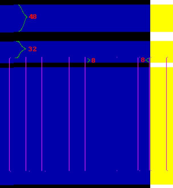

Reply 4 of 9, by GloriousCow
Sorry, yes, you're right. I was just proving that to myself by decoding the video 'stream' from the bus traces and then drawing all writes to 3D4 on top of it.
5.01 KiB
820 views
Lake effect CRTC timings
The bus decoder has no concept of CRTC register state (yet) so it just ticks a scanline every hsync. that's fine, because that's MartyPC's conception of a scanline, too.
Once the effect starts doing its thing with the two side by side rows I need to start counting each of those toward R7.
I was thrown off by thinking that R4 was 1, but at the time it is set, we are overflowing it, so it isn't really relevant.
Well, that's a relief because it's literally a one line fix. I did NOT want to try to emulate phantom vsyncs. Thanks for your help.

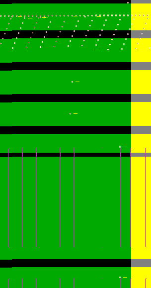

Ok. I love reenigne's write-ups so I don't want to preemptively spill the beans on how the effect is done, but I do plan an article that at least discusses debugging this interrupt set up chain, from an emulation perspective.
I'm really pleased with this 'video stream' visualization. If you just don't vsync and you keep the edges of hsyncs lined up, you get a nice frame flow.
I took some screen grabs from some of the hardware captures of Area 5150 on youtube that showed at least one 'glitch frame' while Lake set up, and can line them up with the logic analyzer capture:

Speaking of visualizations, I think I am going to build something like this into MartyPC as a scrolling event viewer. I was going to do some sort of logic analyzer view, but the extra dimension really comes in handy to see a longer period of time. However, events can overlap...
6.32 KiB
722 views
area 5150 isr setup timing
here is Area5150's ISR chain and ultimate effect ISR and starting frames. leading INTR edges are in red with a little glow applied for visibility. yellow lines are INTA bus cycles; pink dots are CRTC updates.
