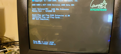

I just got a nice Asus CUBX-L motherboard together with a LinLin Adapter and a Tualeron 1200.
Is there any way to modify the bios to show Tualeron instead of Celeron?
Reply 2 of 5, by Storm82
Sadly it does not change the CPU name from Celeron to Tualeron.

Reply 4 of 5, by Storm82
I know. I just want it for aesthetics 😁
I've seen a screenshot from one guy here who had customized his bios but I can't find it again
Reply 5 of 5, by Storm82
After fiddling around with BP Patcher and flashing supposedly corrupt bios files, I just extracted the stn.bin from the bios and hex-edited the Celeron string to Tualeron 😁
