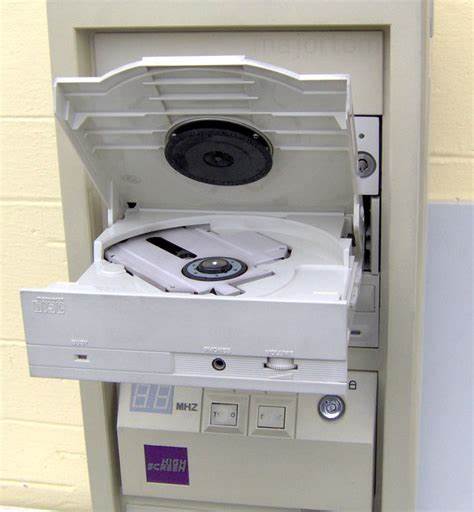

CR-563B is only quirky by modern standards. By the standards of the early 90s, it was pretty normal. Yes, SCSI was better, but most people who had CD-ROM drives during the CD-ROM boom had LMSI, Mitsumi, MKE or SLCD proprietary interface drives and they were all slow with high CPU utilization. In my opinion the MKE was probably the most common of the bunch. Now this is what I'd call quirky:
OIP-C.8AAor7C8AelH6fRRIhBNMAHaIA?pid=ImgDet&rs=1
