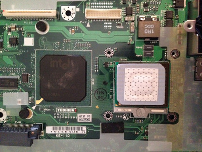

Reply 42 of 161, by Warlord
vorob wrote on 2021-01-29, 15:36:
401 and 603 connection slot difference. Interesting that 401 uses a generic mini PCI card and can be replaced with wifi one, while 603 used smth different.
On my laptop I pulled the modem card out becasue who needs that, and left the lan part.
crazii wrote on 2021-10-08, 02:00:
I don't quite get it. have a Toshiba satellite pro 4300 and its Yamaha YMF744, (744B-R) ,it uses XG driver on win98 and no Dos driver needed at all.
Is there really any big difference between 744 and 754?
It' could be that on that laptop they managed to wire the sblink in the PCB and on the geforce models they didn't bother to wire the SB-LINK so we require the TSR. Fortunatly the 815 still does pc/pci and we have a modefieid setupds tsr to work with the ICH2 on the 815 which will do ddma in software I guess.
