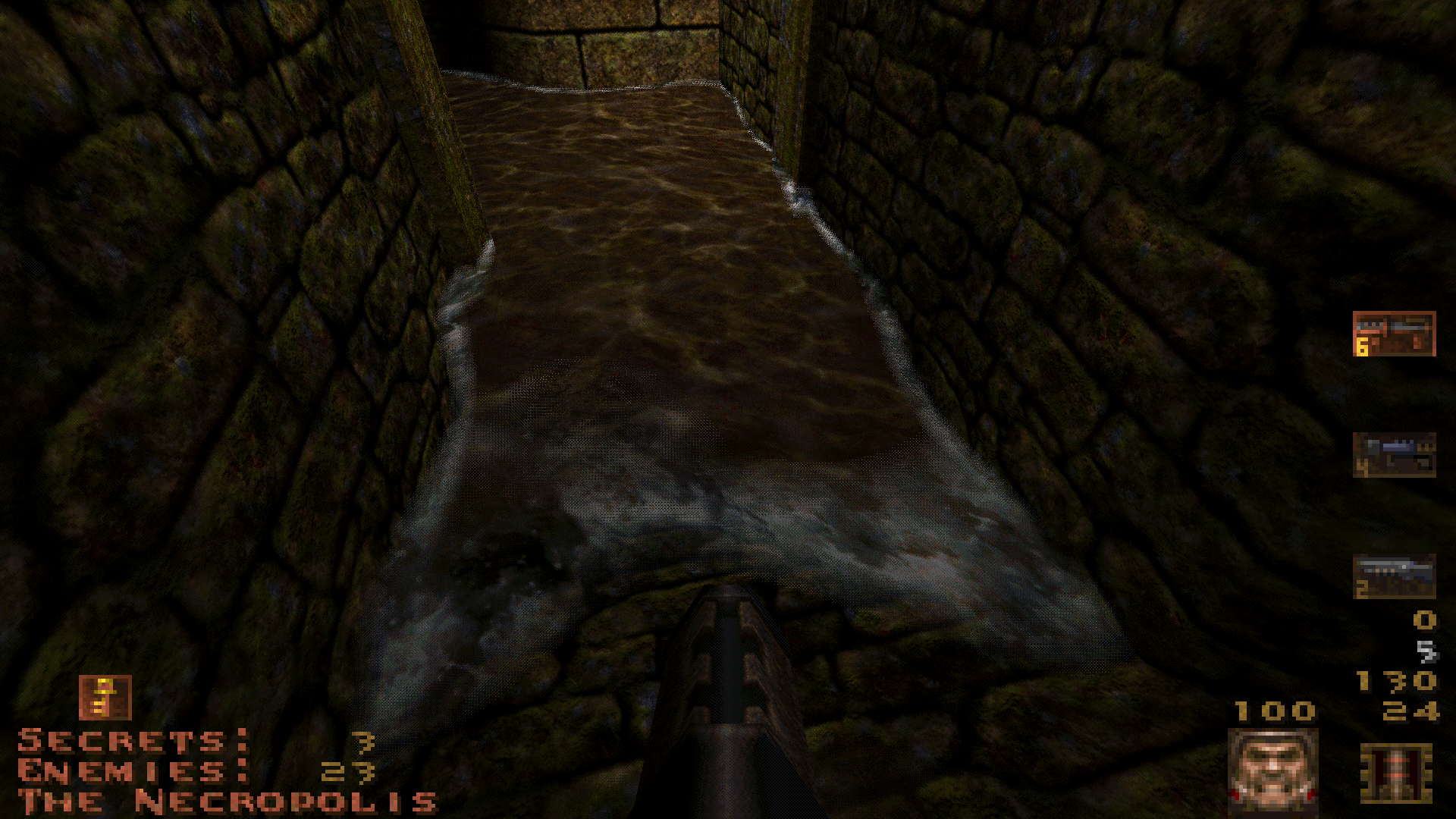

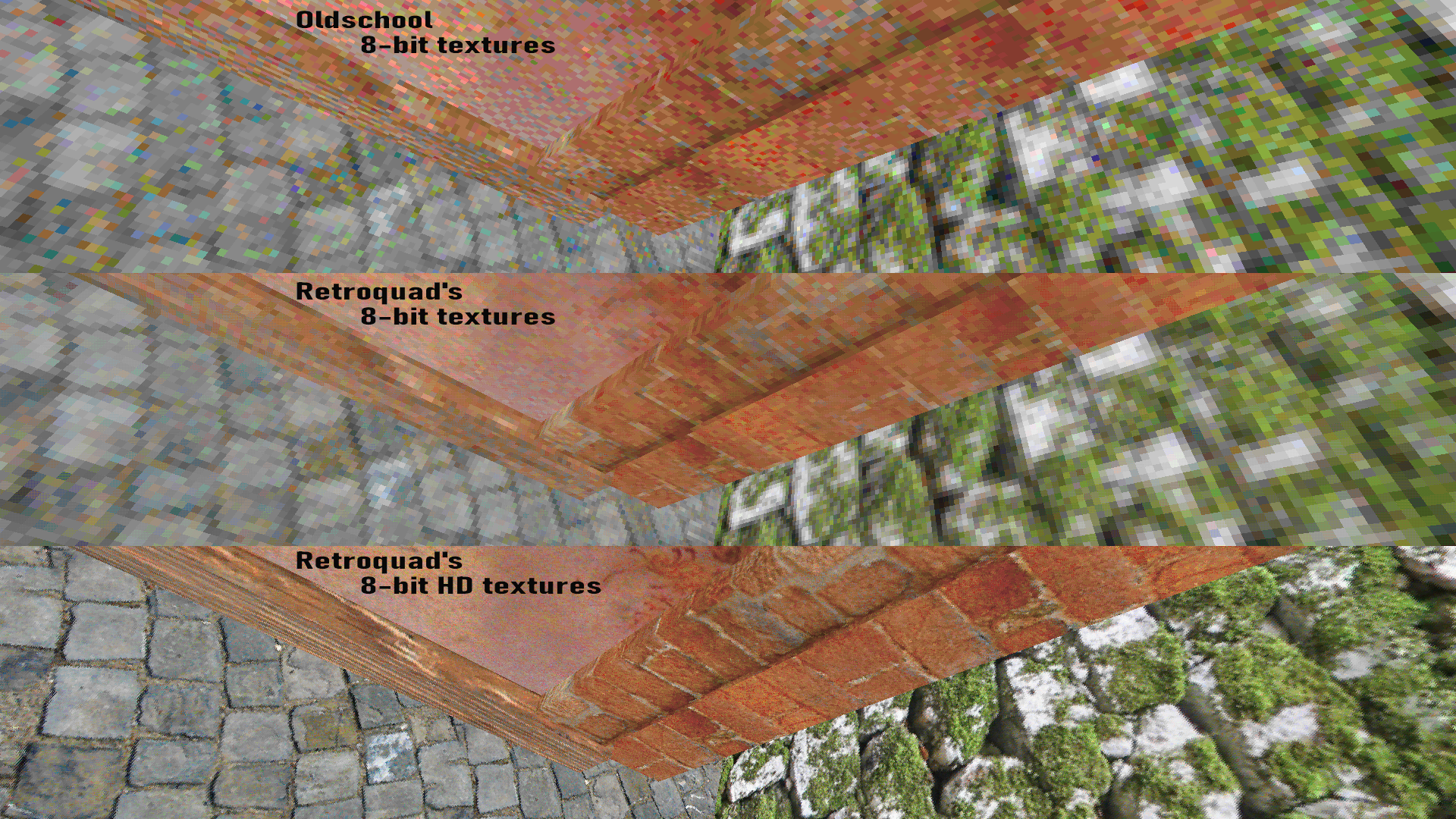

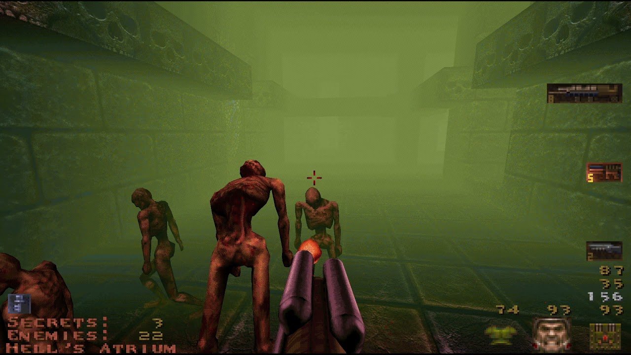

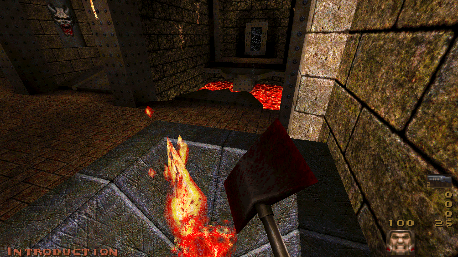

Here are some screenshots & videos:
https://www.youtube.com/watch?v=aBW4xru6x4s&l … aVkLog&index=19
https://www.youtube.com/watch?v=ocScAD3t8EA&l … aVkLog&index=21
https://www.youtube.com/watch?v=tT2YlXrDQRc&l … aVkLog&index=16
https://www.youtube.com/watch?v=D6NoZyTYyZw&l … aVkLog&index=17
FDuAGiTX0AUXKXp?format=jpg&name=large
E_GcSYaWYAIdRR5?format=png&name=large
E8OuUVlXMAArCy4?format=png&name=large
E7Q2Bz0WYAI9Fpf?format=png&name=large
EzIEhZXXEAUfGMY?format=png&name=large
