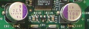

Reply 2 of 6, by adalbert
ChrisK wrote on 2021-12-15, 13:42:
Also I'm not sure if these (really expensive) polymer caps are really needed as these weren't on the marked back then when 3dfx was alive.
Polymer caps did exist back then (Sanyo OS-CON), and Voodoo 5 seems to be using them for the two biggest capacitors:
13.79 KiB
767 views
I don't think there is a need to replace these two caps if they don't show any symptoms of damage, as the polymer used in such capacitors shouldn't be prone to degradation.

adalbert wrote on 2021-12-15, 14:59:
OK, did think the Voodoo 5 came out before/around 2000 and the OS-CONs appearing on the market not before 2010. Also did not think they would be used on consumer tech because of their high price.
Still not seeing much relevance for most applications for them. At least I have never made any design using them. But ok, depends on application and market.
Full ACK.
