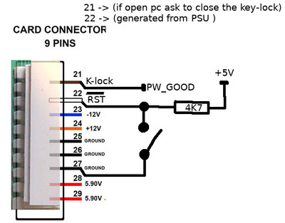

Finally the circuit for the olivetti PCS-11 has arrived and I have also understood the whole pinout of the power connector.
Reply 102 of 127, by dataino.it
This is the pinout of the connector, the first pin at the top is the Key-lock, if I leave it disconnected (open) the pc stops at startup and asks to close the key-lock.
For simplicity I have connected it to the Power Good
This is also the scheme to manually generate the reset and the pinout of the connector

Reply 105 of 127, by pentiumspeed
Yes, still not correct on what is they are for, and a lecture:
Reset signal is to reset stuff, manual or automatic.
Power Good is a signal that power supply is going through intermediate voltages, there is a monitoring circuit in a power supply that controls the power good signal, as power supply starts up then once voltages stabilizes, the power good signal is sent from active high to low *LAST*. Power good is like "whoa, hold your tails while I (power supply) get ready". And this is good reason. If voltages are in intermediate state, can damage or lock up the computer, even blow the ICs somewhere else. Believe, me I have seen this happen!
Your is done same way but this is simpler circuit instead of doing complicated way doing power good signal. Remember this "power good" was IBM started this standard in 1984. But lot of computers from the beginning way back needs automatic reset to start correctly. All computers from the first computer had to be reset manually or automatic, because when everything was powered up, they were in garbage state so reset pulse is sent down to the everything and they go from confused state to beginning of "zero" and running in known in correct configuration then processor starts executing from zero address for example instead of starting in middle of video card's firmware for example. 😀
Apple II and IIe had to be manually reset by hand. Manual calculators has a lever to reset them to zero. Same concept!
The pico-power board have power good signal even in ATX pinout.
Power good is routed through a small circuit that converts this to operate the reset circuit of rest of the motherboard.
If the reset has a line over the word, this means active low. You need to convert power good signal from active low to active high in order to de-assert the reset. In other words when power good is held high the reset is held low till power supply circuit stabilizes then power good signal goes low, the reset is now de-asserted to high and computer starts.
You need a transistor and few resistors to convert high to low or low to high either way. You need a correct way of doing using power good converted to reset signal so this is done correctly and automatic.
Also add a push button connected to the reset pin for manual reset if computer crashes.
