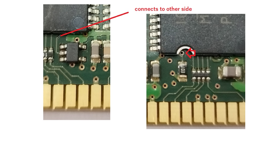

Reply 67 of 88, by snufkin
My guess is that the side of the 10k resistor (marked 103) you've marked with the arrow will connect to pin 147 of the edge connector. The other side of the resistor probably connects to Vcc. That would mean that if pin 147 isn't driven by the motherboard then the middle pin of the 5 pin chip (input A) will be pulled high. That chip is probably in inverter, so the output pin (bottom-right, Y) will then go low so that the bus drivers default to registered mode. I think the easiest way to convert it is to move the resistor so that it connects to Gnd instead of Vcc. That will pull the input to the inverter low, so the output will be high, so the bus drivers will be in transparent mode (registers turned off).
240.56 KiB
951 views
Check that the wiring matches what I've marked in the photo. If it's all ok, then I'd probably try lifting the 10k resistor, tape off the Vcc pad, then put the resistor back using what I think is the nearby Gnd via. Be careful not to short Vcc to Gnd. Assuming that the motherboard doesn't drive the pin (it probably doesn't) then that should work.
I don't see the 'T' structure anywhere, so there may not be the option of fiddling with what I think is the phase adjust to get the best timings.
Reply 68 of 88, by BLockOUT
(yes, you are right on all in your picture!,
top side of 103 has continuity to the REGE golden connector)
+ VCC points have continuity on the left picture
+ Ground points have continuity on the left picture
+ Y point on left picture has continuity with Y on the right picture
+ Grounds on the right pictures have continuity
+ VCC points on the right picute have continuity!
Reply 69 of 88, by BLockOUT
snufkin wrote on 2022-08-09, 08:33:
My guess is that the side of the 10k resistor (marked 103) you've marked with the arrow will connect to pin 147 of the edge conn […]
Like this?
1) i remove the 5 leg thing
2) i remove the 103
3) i place 103 on the other side, on the 2 bottom left legs
Reply 70 of 88, by BLockOUT
sorry missed this comment.
yea your idea is even better, i can lift the 103, then use some green mask with UV light over the vcc area, then place back the 103 and use a little wire to conect the other end to the near ground point.
i think that is more elegant, But what about the 5 leg inverter thing on the other side, should i leave it on the pcb or should i remove the inverter?
Reply 71 of 88, by snufkin
BLockOUT wrote on 2022-08-09, 15:21:
That stays. The 10k resistor is on the input pin of the inverter, normally pulling it high, unless the input is over-ridden by a signal coming in on pin 147 from the motherboard. By connecting the resistor to Gnd instead of Vcc then the output of the inverter will change to being normally high, unless over-ridden by the motherboard, which should put the bus drivers in unregistered mode. The unregistered SDRAM pinout has pin 147 as not connected, so chances are that the motherboard can't change the input to the inverter, so the SDRAM will be set to unregistered.
The other option is to remove the inverter and short the input and output pads. That's sort of what I did originally (on my stick there was space for a 0-ohm SMD link to short the input and output) until I finally found out about the REGE pin 147, at which point I figured it was neater to just change the pull-up/down resistor.
[edit: incidentally, there are a couple of empty pads to the left of the inverter. If you haven't already, might be worth checking if they go to the inverter input (middle-left) and output (bottom-right). If they do, then removing the inverter and shorting those pads might also be fairly neat. I still prefer changing the pull-up/down resistor as it's easier to undo]
Reply 72 of 88, by BLockOUT
snufkin wrote on 2022-08-09, 16:27:
thanks, no those empty pads don´t have continuity to any of the 5 legs.
there are 2 pads on the other side but only one has continuity to ground.
probably this week i will work on desoldering the 103 but i want to be careful, i bought a desoldering tweezer but its so big that i cant even fit it between the memory and the 103. I don´t understand how they don´t sell these things super micro small for smd components. And i also need to find a cheap motherboard just in case because my pentium3 motherboards are high quality and difficult to find replacement.
then run memtest for some hours
