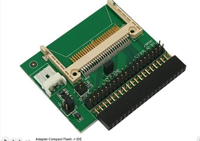

I want to connect CF Card to Ide - Intel Pentium 2 system
Could I just ignore it or do i need to connect psu power?
Should i set 3.3v (default) or 5v?
I want to use it with generic 1gb kingston cf card 33x speed

If its a 44 pin IDE cable IIRC it can get 3.3v from that which is the default setting, if its a 40 pin IDE setup then Yes, the 4o pin IDE cable doesnt supply power at all so the adaptor needs a supply of 3.3v/5v from the floppy to power the CF card.
IF you are using this in a PC then youll need to attach power to it.
44 pin IDE is Laptop IDE
40 pin is PC IDE - this one needs the floppy power connector
The 3.3v/5v setting is used if you are using a CF card that need 5v to run, not seen one like this myself so best to leave it on 3.3v. (Turns out CF can run at either voltage, 3.3v is default)

Reply 2 of 19, by jmarsh
Connect a floppy drive power cable and set it to 5V. All compact flash cards can run on 5V, using 3.3V just enables a pointless voltage regulator (the 5V IDE signals still get passed directly to the CF card...).

Reply 6 of 19, by jmarsh
Jo22 wrote on 2022-01-23, 09:10:
So yes, virtually all CF cards are made with 3.3v in mind.
They can handle 5v, of course. But it's not exactly healthy for these cards.
They handle 5v perfectly fine because the compact flash mechanical specification says they must. Saying it isn't "healthy" is rubbish - especially when they are operated in "true IDE" mode (by grounding a pin, which is done by the IDE adaptor) and IDE uses 5 volts by design.
Reply 7 of 19, by mpe
Even when using 40pin.
Some connectors do provide VCC on pin 20 and many CF cards happily power the card from pin 20 if available.
But it is more likely than not that you have to use external power. I modified some of my IDE controllers to supply +5V on pin 20.

You are wrong. The CF specs say CF cards have to comply with PATA specs, and work with both 3.3V and 5V. The easiest link to understand is https://en.wikipedia.org/wiki/CompactFlash (unless you want to google more technical documents, of which there are plenty online).

Another thing to keep in mind is that some 40pin adapters don't route pin 20 to the card. So even though the hole is there and your IDE connector supplies power, you'll still need to use the floppy power connector.

I played around with a lot of different CF devices in retro PCs in the last two years.
I suspect that some day there will be a new CF that doesn't like 5v, but that has not happened yet.
The only CF device that I've encountered that required 3v to work was an SD -->CF adapter.
