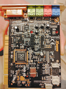

I recieved the Orpheus and I must say that I am quite impressed. The OPL tickles my ear and everything feels right!
The card is very quiet and this alone makes it incredibly desirable. The quiet parts of OPL soundtrack are so distracting.
I have noticed that the Windows 95 drivers possess some sort of annoying latency issue. Sounds in Windows games are delayed by about 3/4 of a second as well as having low volume. Doom in a dosbox runs at normal latency however. Dosmode applications have proper volume and latency. Quite puzzling.
I have heard that Windows drivers for this thing are likely a dead end so I am not sure how much you can help me...
I know that the card is essentially designed around pure dos gaming. But a high quality basic Windows sound card would also be useful... Who needs A3d and EAX anyway when you have the quality this thing has.
Its probably Windows reinstallation time. Just wondering if anyone else had the same odd behavior.
Thanks Mr Dallas and Ferreira! 10/10!!!! Highly satisfied!
Reply 830 of 1061, by keropi
Shcookius wrote on 2022-01-25, 03:49:
Thanks for the kind words Shcookius! I am very happy to hear you are enjoying the Orpheus 😀
I have not heard this windows issue before... what cpu does your system have? the latest PV2860 version of the driver is working very well with a P1 system whereas a 486 for example is better if it uses the previous 272 version. It is possible that 9x messed up drivers so a re-install will certainly help there.
The 9x drivers are pretty robust (if you exclude the fact they are locked to using CSFM for OPL) and should work just fine. Keep in mind to disable SRS (or alter it to your needs) from the icon in the taskbar.
