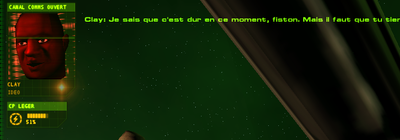

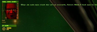

Hello,
There's a small font problem when trying to use Dgvoodoo 2 with the game Edge of Chaos: Independence War 2 (Dx7).
The font is distorded with the wrapper.
The problem do not occurs without the wrapper and whe ntrying with wine3d for windows.
I put some examples in attached file between dgvoodoo2 and wine3d for windows (both tested in 2560*1440, but the problem appears in any resolution).
I use the retail version and patch f14.6.
    101.02 KiB
    289 views
    46.9 KiB
    289 views
    94.68 KiB
    289 views
    43.41 KiB
    289 views
