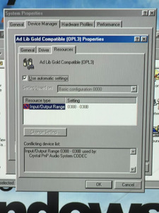

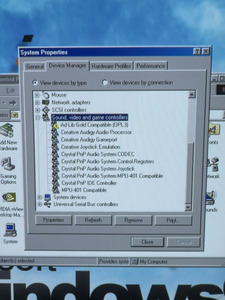

Is there anything needed to be done in Windows or will it automatically switch to using OPL3 now (after we move the jump and change the card type to OrpheusII of course). Am I supposed to disable anything?
This is what my system device manager looks like in Windows 98SE, hasn't really changed any since flipping the jumper or running orphinit with the new version.. Just wonder if I am missing something?
