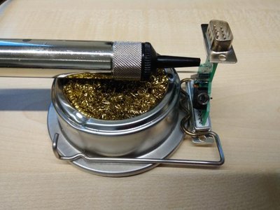

Turns out my soldering iron cleaner/holder is useful for more than one thing:
The attachment db25_desoldering_lifehack.jpg is no longer available
#lifehacks 😎
