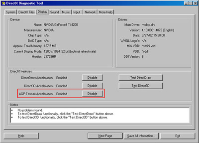

I did notice one difference under Win9x. With the newest BIOS, dxdiag reported "AGP Texture Acceleration" as "Not Available". But with the oldest BIOS, it is now correctly reported as "Enabled".
68.18 KiB
3076 views
Under WinXP, this setting was reported as "Enabled" using both the old and the new BIOS.
Reply 11 of 17, by bloodem
Interesting. Although, I'm pretty sure that's an effect, not the actual cause (since lack of AGP texturing would not cause such a dramatic hit in performance).
So it's probably related to the BIOS bug, but something else more sinister is happening behind the scenes. 😁
