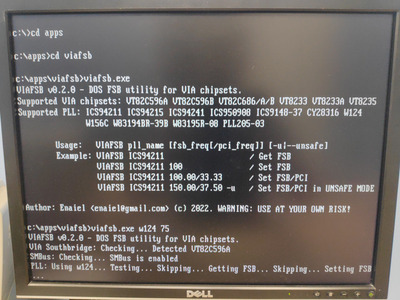

Reply 57 of 93, by Zeerex
No dice still for ICS9148BF-37, results attached for SET safe and unsafe. I'll keep searching in cyberspace for the correct datasheet with the 'BF' in the meantime.
Reply 58 of 93, by Grem Five
I have not had any luck with the winbond machines
[*] DFI CA63-SN W83194BR-39B
As you can see from pics viafsb isnt showing right FSB just loading the pll
[*] Asus P3V 4X W83195R-08
I noticed on this one it says Detected VT82C596A southbridge when its actually a VT82C596B I dont know if that has anything to do with the error or not.
Can you please run VIAFSB with the dump option?
VIAFSB [pll_name] [fsb_freq] -d > dump.txt
The dump file will tell me what it's actually reading. Thanks for testing!
