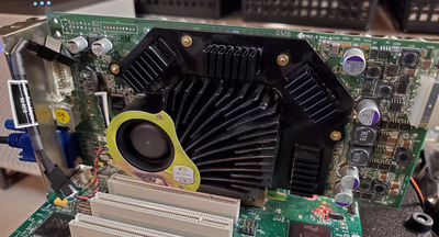

I know that the stock FX 5900 heatsink is a pretty terrible design, but I was unprepared for just how loud the fan is on this thing. It really does sound like a tiny jet engine. It's funny how this was lauded as such an improvement over the FX 5800, I've never owned or heard one in person, so I can only imagine what that was like.

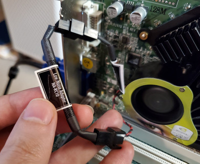

I noticed during testing that the card doesn't get got at all, so I modified the fan header with a Noctua resistor accessory. It's barely audible now and only manages around about 60C when running 3DMark 2001.
The motherboard I'm testing it in right now is a very underpowered Pentium 3 650-100 Mhz, and the AGP slot is only 2x, so it's definitely being held back. I wonder how it would fare unrestricted.
This is the basic FX 5900 128MB model with OEM heatsink, clocked at 400 / 425 Mhz (core/memory).

Reply 1 of 8, by Joseph_Joestar
Kahenraz wrote on 2022-04-23, 09:05:
At default settings, 3DMark 2001 is not a very demanding test for that card.
You need something newer like Doom 3 or Far Cry with AA and AF turned on to put it under heavy load.

On a Pentium 3 650? If it runs at all it won't be playable.

Just noticed the system he's using. Yeah, that's a huge mismatch between the GPU and the CPU.
You want something like an Athlon64 3000+ or better in order to properly drive that card.

Quick reminder that GeForce FX 5900 coolers are actually software controllable.
