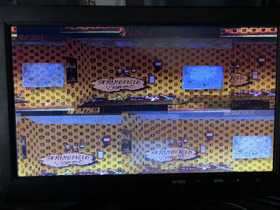

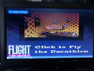

Reply 381 of 1102, by NachtRave
So with Flight Unlimited, I went back to it, and found it uses SDD 5.1a. So I again put back in the modified UniVBE driver for closer testing - it shows the intro screens but doesn't progress to the weird 3d main menu they've got going on (in fact it just hangs and then resets the entire weeCee after a minute - this tends to be the standard behavior of most things I've tried, if not just a direct crash back to DOS). The same result happens when you try to run it using the +nounivbe command line option for not using UniVBE (which is talked about in the FU readme). Running NoUniVBE beforehand didn't help much either, as it caused it to immediately crash instead of hang (an improvement - at least it didn't reset the weeCee).
However, I noticed that FU has a fun little batch file, video.bat, that runs"uvconifg.exe -gen -p ." off the CD. So for kicks I try just running uvconfig normally (which opens a little menu screen), selecting the default search return options it gives me for TSeng Labs "ET4000/W32 unknown revision" 2MB 8bDAC (which has worked in a number of other univbe/univesa configs I've been through already) along with checking "Disable VBE 2.0 extensions" and tried that driver. This driver at least allowed me to play more of the game in a way, but it creates massive screen distortions and screen overlap effects in the main menu, with the main game playing just as badly. At least the preflight and flight recorder screens worked using this mode (an improvement over the SiSVBE option).
The attachment 858AA941-FC22-4CCE-B0F4-E97AB91E2C1A.jpeg is no longer available
If I simply try just running "uvconifg.exe -gen -p ." (as video.bat does), that just drops me right back to DOS after creating the new driver file (no menu or anything). Running FU using this driver just leads me to a blank screen, but you can clearly hear the main menu sound effects playing (and interaction sound effects as you move your mouse around). It is at least not hanging or crashing before going into the main menu, like it does normally, but it's a completely blank screen (I even tried connecting the VGA cord directly into the monitor instead of through the OSSC, but it's still just a blank screen).
As I try to also continue messing around with other uvconfig options (including forcing various different chipsets) it's about the same, with most uvconfigs just crashing FU outright right after intro screens. A few other TSeng Labs options do about the same with the blank screen where you can still hear the main menu running and such. No configs that just /work/.
At least running Flight Unlimited with the SiSVBE beforehand allows you to play the game, it just garbles up the intro scenes and the preflight and flight recorder screens. The main game plays flawlessly tho. This is still the best option I have found, but it is of course lackluster.

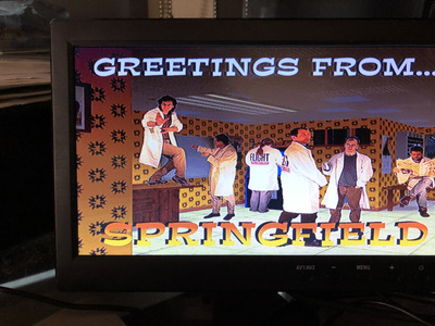

At least FU has cheeky dev photos like this:

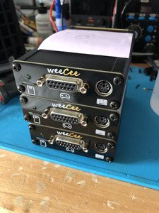

In other news, I finished my extra units and have the first one up on eBay (no link but easy enough to find). If any of you wanted to buy one, now is the time. Next month I have to start looking for new work, so this has been the summation of my time off. :3

Oh, and I guess I let my mom convince me to build another 4 units, just because she thinks the ones I made are worth way more than what I sold them for. I dunno, I'm not out to take advantage of anyone, but I took her advice and bought all the parts for another 4 units, and this time put it on a different credit card so I could track the expense a bit better. I will have to sell these at auction rates tho, just because of the time investment. New boards are ordered, new parts too, only had to sub 1 or 2 additional parts out (which was fairly easy to do so). BIOS chip had to get the -M/SN version, but seems like the same thing basically. The only main thing I had trouble with, again, is the 3.3 LDO, which I did kinda find a 1A (similar to Muon's actually I believe (or someone earlier in the thread)) that I'm sure will work, but also ordered the right one from China. Crystal chips ordered off same eBay supplier, as are SOMs + connectors from WDL (US distributor). Unfortunately again with the SST NAND Flash, that I have to manually disable, but luckily is only a single resistor (or just the whole NAND chip, take your pick).
