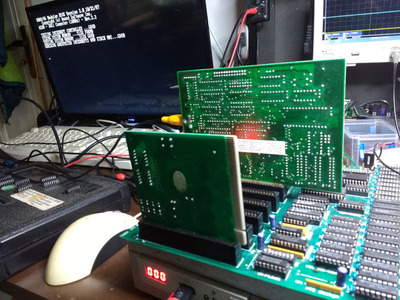

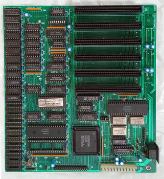

Hello,
Anyone have any information about the jumpers on this card?
While starting correctly it stops as seen on the monitor.
I have tried various combinations but what I got is to disable the keyboard, or the onboard controller
Reply 1 of 1, by Predator99
Is this 8088 or 8086, cant see on your photos?
For me it seems all tests are OK and it tries to boot - but it doesnt detect the floppy?
I would try to insert a ROM-card, i.e. XT-IDE and verify its executed.
