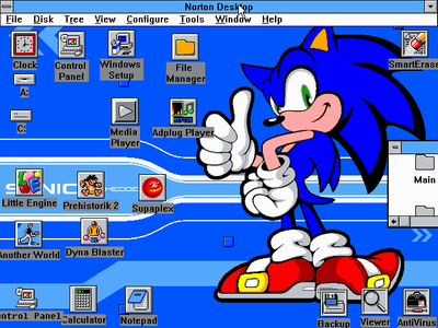

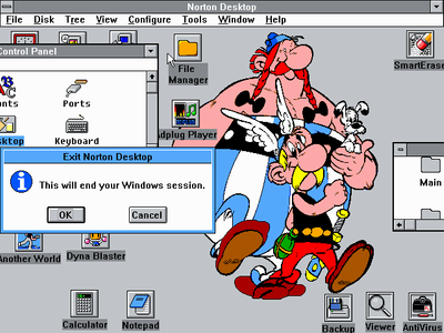

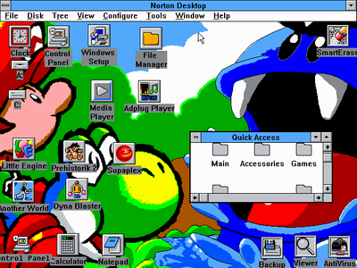

Reply 5 of 6, by mills26
The generic VGA driver has a table containing the EGA color indexes to be used (from the 64 colors available in EGA), replacing this hex string changes the colors:
Original: 000c0a0e011523070f241236092D1B3F
Custom: 00040214193536070F24122609272B3F
You can use these custom 16 color with no problem, but windows won't recognize some of them if it loads .bmp or .ico files created with modern software.
To use images with that palette draw an image with "EGA_Nice_Palette", and set "EGA_Export_Palette" before you save it.
EGA_Nice_Palette
#000000 #aa0000 #00aa00 #aa5500 #ffff00 #ff55aa #0055aa #808080 #c0c0c0 #ff0000 #00ff00 #ffaa00 #0000ff #ffaaaa #55aaff #ffffff
EGA_Export_Palette
#000000 #aa0000 #00aa00 #bfa940 #0c6f8b #820080 #5555aa #808080 #c0c0c0 #ff0000 #00ff00 #ffaa00 #0000ff #ff00ff #55ccff #ffffff
27.88 KiB
919 views
25.81 KiB
919 views
25.49 KiB
919 views
I think it looks awesome for VGA machines stuck in the 16 color mode 😀.
