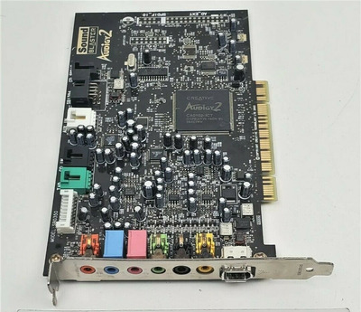

Reply 9 of 22, by mrzmaster
Joseph_Joestar wrote on 2022-05-25, 15:00:
BTW, it might be worth checking if the original (non-ZS) Audigy2 suffers from this problem. There is some indication that it doesn't.
Interesting. It looks like the Audigy 2 (non ZS) exists as both model number SB0350 (which is the same as the ZS) as well as SB0240. Any idea what the differences of these are?

Reply 12 of 22, by Joseph_Joestar
mrzmaster wrote on 2022-05-25, 15:52:
Here it is, albeit from a current eBay listing.
At first glance, I see that the AD_EXT and JOYSTICK headers are unpopulated, meaning no LiveDrive or gameport connectivity. It also doesn't appear to have gold plated connectors.
I think that might be an OEM card. If the seller has more photos, check if there are three large white stickers on the back, that would confirm it.

Reply 13 of 22, by mrzmaster
Hey, good catch. I can't believe I missed that - I definitely haven't had enough coffee this morning. 😁
It looks like the gold plated SB0240 Audigy 2 cards can be had very cheaply. I will grab one of those and test the vxd drivers on a fresh install of Windows 98 and post my results with the CD Digital option.
