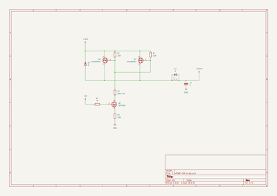

Hello.
About the idea of pumping the 3.3v from the ATX psu to the CPU IO and then to the step down converter for CPU vcore.
As I mentioned in the thread about the ATX pico, I was thinking that the 3.3v line should be controlled by a mosfet. The logic being that the 5v power good line of the PSU goes high once the power rails are stable. It would be nice to have the cpu get power once the psu rails are stable and not before.
So I was looking into the topic and spec sheets and I came up with parts and a potential circuit.
2 p-channels in parallel to help cut the resistance and spread any heat HSU60P02.
Resistors to pull them high thus keeping the mosfet off, protection diode for any reverse current.
Then an 2n7000 n-channel mosfet that is switched on by the 5v power good signal that should pull the gates of the p-channels to ground thus sending power to the CPU.
What do you think?
I never made a circuit with a mosfet before so I could very easily be missing something important. It's nice to actually feel like I'm starting to understand mosfets, so even if the circuit is a waste, may have learned something from it at least.

Reply 103 of 240, by mkarcher
CalamityLime wrote on 2022-06-07, 00:38:
That sounds like a good idea (preventing the CPU to get overvolted by cutting off the supply until it is stable) at first glance, but depending on the mainboard, it's not. When the power good line goes high, the mainboard might expect that all components already have stabilized power and may immediately start operation of the system, for example by deactivating the RESET signal. If the CPU just starts getting powered at that point, it might not be able to perform a clean power-on reset and behave strange. It highly depends on the board, how long after power good going active it takes until the board expects everything to be in perfect working condition, so your logic might work on some boards, but it might fail on other boards.
Reply 104 of 240, by mkarcher
2 p-channels in parallel to help cut the resistance and spread any heat HSU60P02. Resistors to pull them high thus keeping the m […]
What do you think?
Your circuit looks a lot like a bipolar transistor circuit modified for MOSFET operation. You can simplify it a lot. But before just simplifying: Drop the 10K resistor between the 2N7000 and ground. MOSFETs are voltage controlled, so you want to have "source" connected to a stable potential like ground to get a clear definition about what a certain gate voltage in respect to that potential does. In your circuit, nearly two thirds of the 5V supply (i.e. 3.2V or the like) drop at the source resistor of that MOSFET, so only 1.8V of the 5V power good signal remains between gate and source. That is likely not enough turn the MOSFET on completely.
Now to the simplifications: the gates of both power MOSFETs is in parallel anyway, so you just need one pull-up resistor. 10K looks like a good choice, though. You can omit the left diode, because all standard MOSFETs have a diode like that integrated by design (the "body diode"). It's even part of the MOSFET symbol to remind you. Relying on the body diode to carry high current over long time is bad style, but it is perfectly fine to use it for discharging the 3.3VP line in the case of powering down the computer.
The right diode seems pointless, too. The inductance of your coil should be low enough that the energy stored in that coil can safely be dumped into the output capacitor in case the processor decides to not need any current at the moment (e.g. HLT instruction), so you don't need any freewheeling diode. For discharge at power down, the low DC resistance of the coil is good enough to provide a current path, no need for that diode.
To protect the 2N7000 (those bastards are very ESD sensitive), you might want to add a small cap (like 100pF) between gate and ground, especially if the gate resistor you use is above a like 33Ohms. That gate resistor and the cap I propose form a low-pass (i.e. delay the turn-on, which might be problematic, see my other post), so don't go too high with the gate resistor if you want quick reaction to power good. And finally, as MOSFETs are voltage controlled, you want something to pull down the gate of the 2N7000 when there is no 5V supply. Relying on the low impedance of the 5V line will indeed work if the circuit is permanently attached to the mainboards 5V line, so no immediate action required - but generally a pulldown resistor (like the 10K pull-ups at the power FETs) is a good idea.

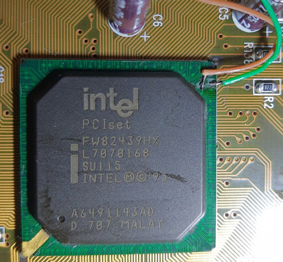

Quick update on the tag ram:
I soldered little wires to the chipset. Not the nicest of soldering but should be fine, I got 2 identical tag ram chips from electomine on ebay and JLCPCB finally shipped the tag ram boards I made.
I also socketed the keyboard controller IC and I removed the din port because it was looking a little destroyed.
About the circuit,
I'll have to look into the point about the board expecting the system to have power already when power good line goes high.
And thanks for the input on the circuit 👍🏻

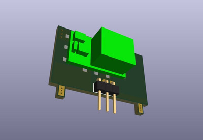

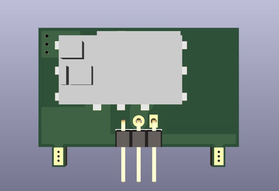

Reply 116 of 240, by CalamityLime
Looking at the gerber files in the other thread, I think I do nothing with the sense lines unless I'm doing something smart.
I started putting together the PCB I had in mind, hopefully in it's current state the idea comes across.
The plan is to replace the PNP transistor and mount the replacement using the holes for the transistors heat sink. I'd have to run a wire to ground but other then that it's fairly drop in.

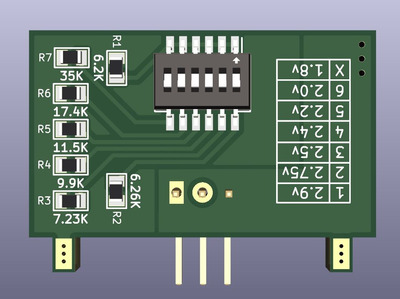

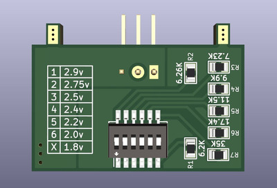

Alrighty!
The back of the board has the resistors and the resistors have values. The table to the side is upside down since I think that's how it'll be looked at most once it's installed.
The resistor network is a simple thing. Default the trim to gnd resistance is set for 1.8v, so hopefully if the switch breaks it won't fry anything. Flicking on the switchs just adds another resistor in parallel to decrease the resistance and up the vcore voltage.

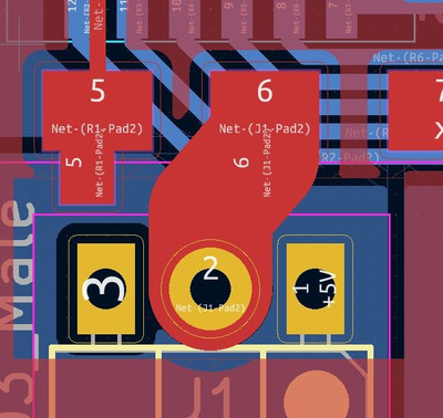

Reply 119 of 240, by CalamityLime
The module is off to the side to make routing a thick trace out vout possible.
I'm wondering what to do with the blank space to the right, a power good LED? A canvas for graffiti?
