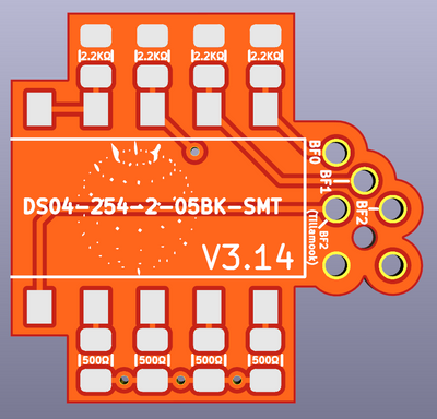

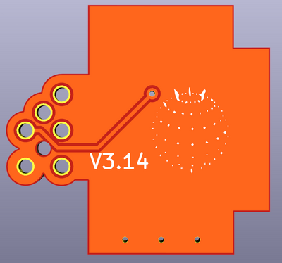

This one is as small as it gets and only for setting multipliers.
Designed to go on the back of the motherboard but also to be as minimalistic as possible

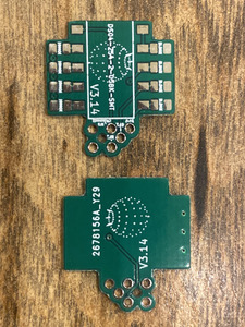

Here is the first beta. someone will have to prototype it to confirm it doesn't need any alterations. (At one's own risk of course.)

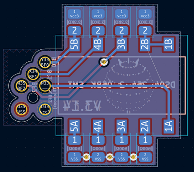

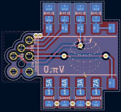

Instructions
The Tweaker is in parallel with whatever signals the motherboard has present. If you already have a pull up present (2.2k) on a particular BF pin there is no need to install it on the tweaker. If you want to disable a pull down you must remove the motherboard jumper for that BF signal as well as turn off the dip for that pin in both locations.
You can fully set all BF registers from the Tweaker, or use a combination of the Tweaker and the jumpers on the front of the motherboard.
For example, if your motherboard can set BF0, and BF1 just fine, but can not set BF2 you could choose to leave Bf0, BF1 unpopulated on the tweaker (or off), and only use the tweaker for setting BF2
If your motherboard is missing pull up signals you can use the Tweaker for adding them.
For example, it is common to be missing a pull up on BF1 and Tillamook BF2. to discover if a pull up is present, remove processor, remove pull down jumpers, and Turn off DIPs. Then look for resistance between the specific BF pin and vcc3
The furthest DIP switch from the pins is for disabling or enabling the Tillamook BF2 pin connection. keep it disabled if no Tillamook is installed. it is known that cyrix uses this pin for other functions.
A guide to what settings give which multipliers would be very difficult to make as sometimes for example the same setting on the same S-Spec intel cpus can give different results depending on the chip. therefore it's just best to figure out which combos do what by trial and error.

Reply 1 of 3, by Sphere478
Looks pretty good. I think I’m gonna pull the edge clearance back a little bit then probably call it good to go.

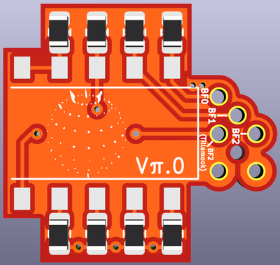

Reply 3 of 3, by Sphere478
Multiplier Tweaker Mini Pi.0.zip
785.28 KiB
19 downloads
pi.0

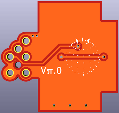

-Improved VCC3 current path
-Pulled the edge clearance back
-Solved the DRCs also did a little trace cleanup.
-Made another path to vss by playing with floods.

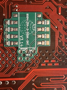

And here is a pic of the prototype.
