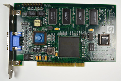

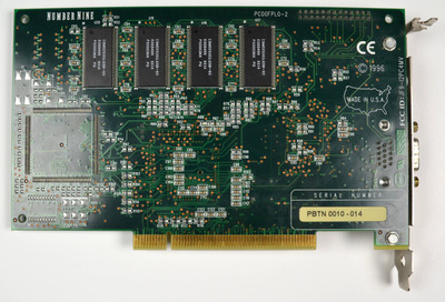

Hi All,
I picked up a Number Nine Imagine 128 II card on eBay recently. The Cirrus Logic chip for basic VGA duties seems to work fine in DOS 6.22 and has a separate 512KB NEC 70ns chip the card. As soon as Windows loads the Imagine 128 II driver, I get artifacting with vertical stipes down the screen (see image). Resoultion/colour depth doesn't seem to matter. I get the same behavior in two different Windows 98 and Windows 2000 systems with the included Microsoft drivers. My initial thought is that one or more of the IBM 60ns EDO chips (there are 8 in total) used by the Imagine 128 II chip are bad.
Is anyone familiar with this card aware of anything that could cause the weird vertical bands that I'm seeing here? Or is my suspicion of bad DRAM likely the culprit here?
The chips are IBM IBM025161LG5D-60 parts, which seem to be very difficult to source these days. From what I can see, this stuff is 5V EDO 256Kx16, 60ns in a PDSO64 package. I can't find exact replacements but I can get a quantity of NEC ICs with similar specs at a reasonable price. They are NEC (UP)D482445GW-60 ICs. From what I can see, they are also 5V EDO 256Kx16 in PDSO64. Any thoughts on this? Also, any tips or suggestions on how to identify the bad ICs? or is the best bet just to replace them one at a time until the issue disappears?
The card:
The IBM025161LG5D-60 memory used by the Imagine 128 II chip:

Reply 1 of 21, by weedeewee
from the example photo you offer, I'd say that some datalines between the memory and imagine128 chip have a bad/failed contact, which could also be a bad chip...

Reply 2 of 21, by pancakepuppy
Did you do any chip squeezing to see if you can make the lines change?
Reply 3 of 21, by lemonlime
Thanks for your replies! The squeeze test was brilliant 😁
I narrowed the issue down to one corner of this DRAM chip here.
If I put pressure on it, the artifacting changes and will sometimes disappear. I took a closer look with a microscope and poked a few of the legs at that corner. At least five of them have bad solder joints. I can freely move the legs side to side. Will need to do a reflow of that area and see if the issue is fixed.

Reply 8 of 21, by lemonlime
Success! There were actually seven pins on that memory chip with bad solder joints. I just reflowed them with a bit of fresh solder and the card now works perfectly.
