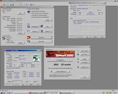

I can’t speak much to dos compatibility but the dos games I have tried seem fine. I usually do 9x gaming so here is what I have found for my uses.
Pci radeon 7500 is my go to for these systems. Have been very happy with them.
https://www.ebay.com/itm/265634597901?hash=it … LQAAOSwxkxiT7Sq
^dreamer pricing.
https://www.ebay.com/itm/333163967067?hash=it … a8AAOSw-mRhgWbB
I usually get the low profile green ones though. I don’t see one right now. I vouch for the short green 7500s

Interested to hear your dos experience with it. I’ve gotten pretty good 3d mark scores (windows) with mine on socket 7
Hopefully the red ones are as compatible as the low profile green ones. I suspect it probably is as it seems to have several regulators and is 5v keyed.
