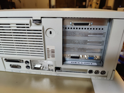

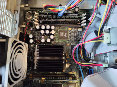

About twenty... five? six? seven... ? Errhhh.. many years ago I learned that there was a CPU called Pentium Pro and that it was very very fast. Since the I have been wanting one and a while ago I got a great offer that I couldn't resist.
1.04 MiB
2081 views

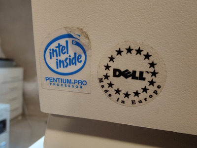

A beige/white and very anynomus desktop case that not too many would think contains any interesting hardware.
832.25 KiB
2081 views

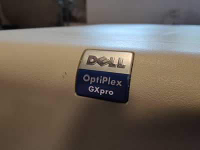

Until you see the little sticker with the Pentium Pro logotype.
Hardware
Cpu: Pentium Pro 200, 256k cache (upgradable to dual Pentium Pro with an extra cpu-card)
Ram: 80mb edo, 168-pin dimm. Seems to be ECC memory.
Graphics card: Matrox Mystique 220 (upgrade)
Motherboard: Dell with Intel 440FX chipset.
Network: 3com 100mbit, onboard
Sound: SoundBlaster 16 Vibra, onboard

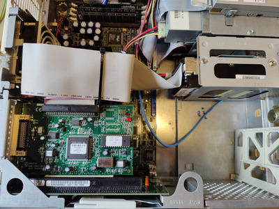

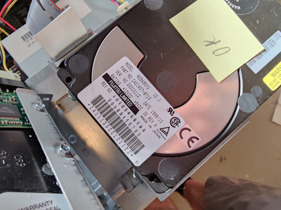

It came to me with a very bad sounding Quantum Fireball at about 2gb so that was the first thing to replace. A serious workstation from this period should of course have a SCSI harddrive so I found a suitable 9.1gb drive from Fujitsu. Not the fastest but good enough for this computer.
1.46 MiB
2081 views

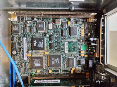

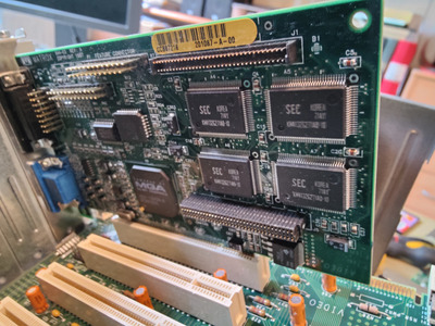

Another thing that got replaced as soon as I had tested the computer was the graphics card. It came with a S3 Trio64v+ and that wasn't really enough for my needs. A Matrox Mystique 220 was the first card I found that I thought was suitable for this machine.
There are still a lot of things to do with this computer and lots of things to test and explore. And probably some more upgrades too... 😀

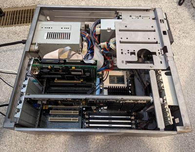

Reply 2 of 20, by OSkar000
bofh.fromhell wrote on 2022-07-23, 15:53:
That's a great find!
Got any more pics? =)
Sure 😀
Its not a very large case but it has plenty of room in it and it is really easy to work with.

Reply 3 of 20, by buckeye
Was it that clean when you got it or did you give it a "bath"? At any rate it looks great!

Reply 5 of 20, by OSkar000
buckeye wrote on 2022-07-25, 15:58:
It was in good shape when I got it so I just removed the largest dust bunnies 😀

Its about time to do some upgrades now, starting with more memory.
This machine uses EDO dimms, ECC but I have not figured out if they should be buffered or not... or if both works. Any ideas?

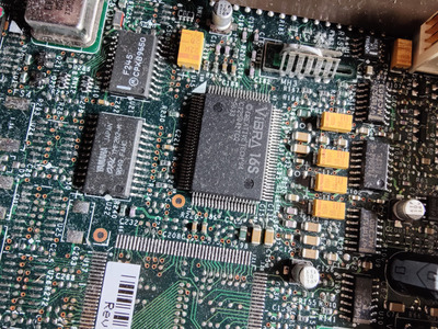

I also have to figure out why the sound output is prettt bad. Lots of noise and even more when I move the mouse...
Reply 8 of 20, by Errius
Oh yes, onboard sound in those days was horrible. Have you connected the CD audio cable to the motherboard? I remember that made it much worse.

Reply 9 of 20, by kaputnik
Oh, the legendary Pentium Pro 😁 Would definitely get one if I had more room in my retro corner.
Assuming the CPU expansion card goes in the brown slot next to the CPU? Is the card installed now some kind of dummy/terminator? Will try to remember keeping an eye out and alert you if I stumble upon something against any probability.

Actually, USB support came already with the 430HX chipset IIRC. Never seen an S7 board with USB ports/headers installed from factory though. On the Gigabyte GA586HX in my P233MMX machine, only the pin header was missing, everything else was there. Soldered in a pin header, put together an expansion card bracket with ports, and enabled USB in BIOS. It's USB 1.0, so the usage is basically limited to a slim selection of low bandwidth stuff like keyboards, mice, etc, but it works perfectly with the few peripherals that supports it. Got an A-Trend ATC2000 430 HX board aswell, which also only seems to miss the header.
Must have been a very late decision to omit USB support. No idea why they did. Maybe they just thought USB would be some kind of short lived thing no one would care much for?
You might be able to find out which memory types are supported from the chipset/northbridge datasheet.
Assuming that you won't let DOS near a Ppro machine, I'd simply disable the onboard Vibra16, and stick a PCI sound card in it. There are a few that works with NT 3.51 too, if that's what you're planning to install.

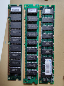

Reply 11 of 20, by OSkar000
1.02 MiB
1780 views
This is the memory that were installed when I got it.
The two ones on the left seems to be ECC unbuffered so thats probably what I should try to find.
Reply 12 of 20, by Errius
Here's the user's guide and service manual
https://ia803404.us.archive.org/9/items/manua … 992/2494992.pdf
https://www.manualslib.com/manual/36727/Dell- … ?page=21#manual
It makes no mention of buffered/registered memory, so you can assume it uses unbuffered/unregistered. This is another difference between our machines then.
I noticed the same things when I read the service manual earlier.
Most (all?) 64 and 128mb memory modules seems to be buffered so I wounder if it works with both types.

Thats correct, its occupied with a dummy card when its not in use. The computer will not work without that card so don't loose it.
I will try to find some information about the memory compability with Intel 440FX. But I assume that there might be differenses within the bios too about what memory can be used. I tried some non-ECC modules and they don't work at all.

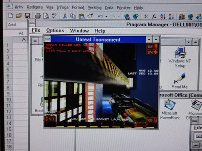

Reply 16 of 20, by OSkar000
1.01 MiB
1450 views

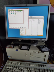

It is time for a little update on this project. Windows NT 3.51 seems to run great on it and I have tried out some more or less relevant software.
Office 97, runs and installs without problems
Winamp, didn't like the installation but a copy of a installation runs as expected
Autocad LT 95, no problems
PaintShopPro 4, does not install
PaintShopPro 3, runs ok!
Windows Commander 5 (?), no problems
Unreal Tournament, a bit slow and no full screen
659.71 KiB
1450 views
I'm still looking for some memory that works in this machine but 80mb seems to be enough for most of my needs at the moment.
Reply 17 of 20, by foey
I had no idea Unreal worked on NT3.51!
Great, well-built machines!
