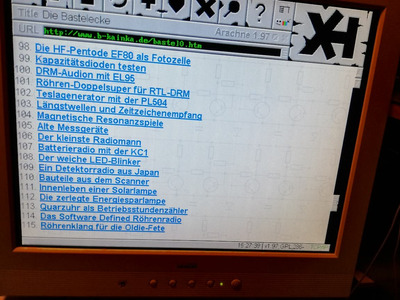

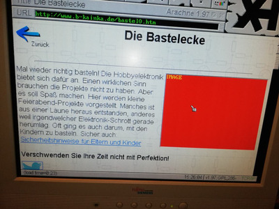

Well, I've just gotten Arachne to work on my 80286 PC, a Schneider Tower AT 220! 😊
The PC merely has one Megabyte of RAM installed for the moment (all slots are occupied, an EMS card is planned), but also an 80287 co-processor.
Now, the "problem" is, that there are just two types of official binaries.
The full version for 32-Bit 386/486 PCs and a lite version for old grandpa (IBM PC, 808x):
http://glennmcc.org/arachne/
(Edit: The 8086 version has no x87 support, unlike the normal version.)
Does anybody know, if there's a semi-recent version with x87 support and "normal" 16-Bit compiled code (80186/NEC V30/286)?
Something that's not an offense to PC/AT owners? 😉
Preferable some port that can handle HTTPS servers?
They're about everywhere by now! 😒
Thanks in advance! 🙂

Reply 2 of 4, by Tronix
I looked at the source code v1.99 and didn't see heavy use of floating point math. The only place where it is used is the arc drawing procedure in the LOPIF library.
The project also uses the WATTCP library, but I did not find its source codes, only pre-compiled .LIB file included.
In any case, I recompiled the LOPIF library and the program itself with the compiler switches set to generate 286 and 287 opcodes.
I don’t know how much this can affect the execution speed, but now the binary code uses ENTER / LEAVE opcodes, shifts (SHR,SHL) by imm greater than 1, push imm/ pop imm, coprocessor commands FINIT, FLD, FMUL etc.
Arachne core V1.99 286/287 in attachment
    CORE-286-287.zip
    207.65 KiB
    69 downloads

Reply 3 of 4, by Tronix
Okay, found WATTCP library source code here: http://www.jkmicro.com/Downloads-TCP-IP.html
I also recompiled them for the 286 processor and rebuilt the program again. Since I cannot check whether the TCP/IP stack will work at all after this, I will leave both versions (message earlier and this).
    CORE-286-WATTCP.zip
    207.73 KiB
    80 downloads
