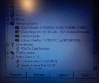

Reply 2 of 7, by Intel486dx33
I have not checked the NET.INF listing yet. How would I be able to reinstall all those networking files ?
Here are some photos of my Networking situation.
The Problem could be Missing PCMCIA card services driver in Device manager ?
Or Missing networking files or services ?

Reply 3 of 7, by ATauenis
The Device manager says that the device is working correctly. This means that all required to use PC Cards is installed.
Try to remove or rename ndis.vxd, vip.386, then remove all network cards and modems and reinstall them. Windows should reinstall the network stack. Don't forget to enter a valid IP configuration.
