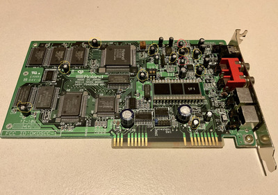

I have a SCC-1 lying here that seems to have a production fault. All capacitors, which should be polarized 10uF/16V types according to the schematic, are equipped with bipolar 10uF/16V types (yellow). But the two positions where bipolar capacitors with 10uF/16V should be, are equipped with polarized 10uF/16V capacitors (red). Apparently, the robot or whatever did the Placement in the factory, mixed up the boxes with the capacitors. The latest date code is 9134. The sound seams to be ok, but i have no possibility to compare.

Bipolar ones where they are will continue to work properly but those two that are not may be reverse biased or not biased at all and eventually stop working.
Reply 2 of 2, by PC-Engineer
Yes, I think similarly. I thought about a complete capacitor replacement and noticed that so a lot of bipolar capacitors are installed. According to the service manual, there should only be two, but exactly this two that should be bipolar are polarized. Strangely enough, the sound sounds ok. I will definitely fix the problem on my card. I want to document the problem here on the forum, as I haven't found any mention of it anywhere else, and it's apparently a manufacturing defect.
