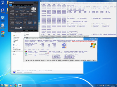

Today I am working in a Lenovo A52 8343 system, and after various try, I really can't enable the famous Hyperthreading.
I think that it's important to enable it to make the operating system see two cores and will be faster.
Anyway, I haven't reach my point yet.
The system is a Lenovo A52 8343, with 3gb of RAM (4gb isn't fully disponible to the system I don't know why even if the bios sees them), a nice Pentium 4 640 HT processors and a motherboard with the 945G chipset.
So, let's come to us.

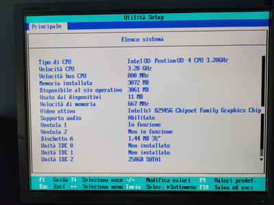

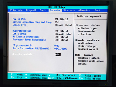

In bios I can see the option to enable/disable the Hyperthreading. I obviously set on Enable.
I tried several times to reinstall the operating system, a Windows 7 Ultimate 64bit.
They wrote that I have to install the operating system to make it see the Hyperthreading processors, so I did.
But nothing changed.
Windows only see Pentium 4 640 processor.
Using ctrl+alt+canc to see the resources gestor, I can see only a core. Often in difficult running to 100 percent, you know.
Using msconfig the core option is unchecked, but if I check it I can only select one core.
If I download Cpu-z it find the processor correctly but in the last line I read 1 core 1 thread.
No way to see 2 thread as it should be with HT.

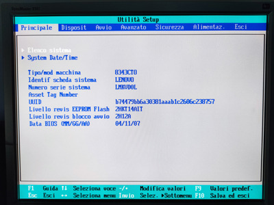

So the BIOS is the latest. Have you tried to "Clear CMOS" or just extract a CMOS battery from the socket ?
P.S. It might be that your CPU model / stepping is not in a whitelist
Reply 8 of 60, by biessea
Roman555 wrote on 2022-11-12, 19:38:
Absolutely yes, I tried.
Clear cmon doesn't work very well I have to say, I unplug the power cord and take off the battery.
This work better 😀
But nothing change.

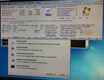

I've run your nice utility.
I put here the screenshot of the results.
Anyway I found CpuId menu under Processors->CPUID->CPU-0, not machine submenu.
Any idea now? More suggestions?

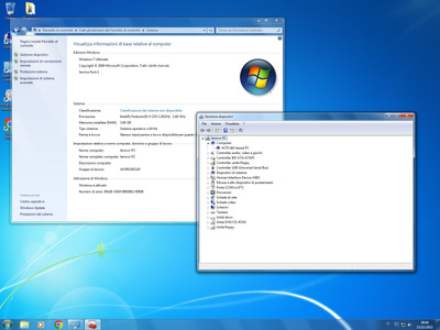

Reply 10 of 60, by Horun
Hmm it is the N0, SL7Z8 version which I thought was the same Sspec as the IBM part, but all that shows no there is no Hyper threading.
Maybe a flaw in the BIOS or something happened during XP install and the ACPI MP hal was not installed.
Go to Hardware > Device Manager > Computer and check the entry for ACPI. If it does not say ACPI Multi Processor then the HT will not be enabled in XP even when enabled in the BIOS....
There is a few ways to change it after you have installed XP. One involves just changing the ACPI in Device Manager > Computer (generally does not work), just choose Update driver and IF given a choice choose ACPI MP...
another is manually copying/renaming hal files, the last is to use a MS tool called Devcon to force a ACPI update.
Added: there is a fourth method using HALu-0.2.0 + devcon but HaLu is a third party executable and do not know anyone who has personally used it.
Do know I have done the hal file transplant and it does work (but with all things if not done proper can cause a system to not load windows).

Here I am.
First thing to say is that I am trying to install Windows 7 ultimate, not Windows XP as you wrote before.
Anyway, this is the screenshot of the device manager. As you can see no multiprocessor identified, so probably this is why Win 7 can't see the hyperthreading.
Now I will operate as you wrote me, with the Devcon file and let you know.

Reply 12 of 60, by biessea
SO I used the Devcon HAL fix utility, extracted files in the root directory without spaces as explained in the text file.. and after reboot the situation is the same!!! ACPI x86 based pc! Isn't changed in multiprocessor!
Now I will try with other way to fix it, but the situation here is completely strange!
Final edit, NO WAY to resolve that problem with those methods you have wrote to me.

Reply 13 of 60, by biessea
And this is some photo of my bios:
    437.68 KiB
    980 views
    bios1
    451.04 KiB
    980 views
    bios2
    439.42 KiB
    980 views
    bios3

Horun wrote on 2022-11-13, 03:10:
Incorrect the [Y]16 Count 2 proves that Hyper threading is enabled on the CPU, further it's also reporting CPUs 2 Cores 1x2.
biessea wrote on 2022-11-12, 23:53:
As Hyper threading is enabled on the CPU then there is either an issue with some other BIOS setting or the W7 installation.
When I booted the W7 installation DVD on my 660 from the attached you can see W7 found both CPUs when I ran it from the command prompt. What happens if you do this on your system?
How many CPUs does Windows XP see? You should be able to boot the XP installation CD and run SIV to check. I can't remember exactly how to run SIV as I have not done this for several years.
What SIV reported was limited as its driver is SHA2 signed so KB4474419 needs to have been installed. Either install it or disable driver signature enforcement at boot time.
file.php?id=149940
Note: driver signature enforcement is disabled when you boot the W7 DVD.
    103.01 KiB
    939 views
