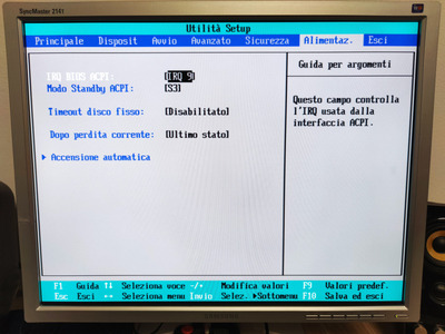

Does BIOS settings have any APIC options ? APIC should be enabled. Also it should be enabled before OS installation (not after)
I have to take a look. Can't you find these instruction in the screenshot that I posted on the second page?
I didn't find. The option is usually placed in "ACPI" tab of a BIOS settings. Phoenix BIOS is not common for me.
Reply 44 of 60, by biessea
Roman555 wrote on 2022-11-13, 22:00:
biessea wrote on 2022-11-13, 20:55:
I've got it. I found that page in "power supply" tab on BIOS.
I think it's all enabled.
I really don't know what to do now, It's freaking impossibile that this system can't enable Hyperthreading cmon!!!

Reply 45 of 60, by darry
biessea wrote on 2022-11-13, 22:54:
I've got it. I found that page in "power supply" tab on BIOS. […]
That setting has to do with power management in standby mode . It is not the setting you were looking for, unfortunately .

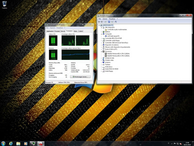

The problem was the bios, the newer version probably have some problem with Hyperthreading or dual core (Pentium D) processors, even if it sees them.
Now I installed Windows 7 Ultimate and the hyperthreading is active and working! I'm so happy, finally I can use and give to my father a system fully functional.
I attach images of the desktop showing the working Hyperthreading.
So at the end, If you have a Lenovo A52, if you have the last bios 2HKT14A YOU HAVE TO downgrade the bios to 2HKT13A to permit the operating system see the dual core or the Hyperthreading correctly!!! I think this has to be know for ages from now, if someone has this old system!
