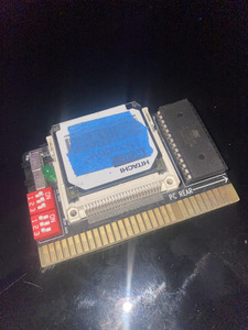

Hm.. Does the Multi I/O card work in the Pentium with the HDD attached to it (on-board stuff disabled) ?
If not, XTIDE Universal BIOS technically can also boot from the IDE connector of a sound card (Secondary IDE).

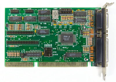

Reply 6 of 65, by RayeR
Hi, I just experimented with XTIDE on my 386 with some HDDs and SSD. The results varies widely. As IDE controller I use quite common 16-bit ISA card with Acer chip, one IDE, one FDC, COM, LPT... XTIDE BIOS is placed in 8kB EPROM at 16-bit eth. card. I disabled all disk in AMI main BIOS.
HDD Seagate Medalist 10GB - detected OK, but before boot it do 2 power off/on cycles like drive reset? Why? Also when write data from some pmode dos program it starts power cycling. It doesn't happen with AMI main BIOS while can use only part of capacity.
HDD Seagate Barracuda 7200.7 40GB - detectes OK, no power cycling bu I hear heads move like after power on. Writting ok.
SSD Transcend IDE44-pin 32GB - not detected - empty device name string, it doesn' work neither with AMI main BIOS.
SSD Samsung mSATA in IDE44 mSATA adapter 32GB - even worse, cause freeze at BIOS POST screen while some characters on screen are missing or messed up. Looks like corruption on system bus when more devices talks at one time?
CF card Transcend 16GB in homemade CF-IDE adapter - detected OK, works as expected.
Note to SSDs - I tested them in Pentium Pro MB with PIIX3 and Samsung mSATA works fine while Transcend freeze at IDE detection.
Any idea what is the root cause of SSDs incompatability? I think that all devices have to support very basic ATA identify command in PIO mode so ut should at least show device name during detection. Or did ATA spec deprecated PIO mode at all on latest devices?

Reply 8 of 65, by RayeR
It's quite a common controller, any low-cost noodle like there. Chipset is Acer M5105 + some buffers and PALs. I'll take some better photo later...
Gigabyte GA-P67-DS3-B3, Core i7-2600K @4,5GHz, 8GB DDR3, 128GB SSD, GTX970(GF7900GT), SB Audigy + YMF724F + DreamBlaster combo + LPC2ISA
Reply 10 of 65, by RayeR
But is it real problem on cca 30cm cable with a single drive? There are buffers on MB-ISA and IDE sides...
Reply 11 of 65, by rasz_pl
It cant be helping.
Your IDE controller on this card is 2 chips, Acer rebranded PAL and one 245 buffer - exactly that kind of thin low cost noodle 😀 All of the rest is logically separate with Acer M5105 providing 2 Serials, LPT, FDC, and Gameport.
Here is similar one, except with two buffers https://www.vogonswiki.com/index.php/Elitegroup_C190
Here is one with provision for one, but manufacturer was too cheap for it https://retrocmp.de/ctrl/testfdc/acer-m5105_02.jpg
Good news is your card also has provision for second 245 buffer, here a populated one
Im going by pcb substrate and soldermask color. Its possible your card has this buffer and Im just barking the wrong tree.

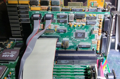

Reply 12 of 65, by RayeR
I found another spare ISA IDE controller. There's a difference that Samsung mSATA SSD doesn't hang the POST but it's not detected anyway, like the Transcend IDE. So it might be some issue at electrical level but there's another problem.
I also tried to put SSDs in one old 486 machine with similar ISA controller but it has HDD autodetection in AMI BIOS. Both SSDs was some way detected with low cylinder number (BIOS doesn't support 16k cyls, Heads=15, Sectors=63, size cca 120MB. The H, S values matches the datasheet of Transcend SSD, see https://docs.rs-online.com/1787/0900766b816b6ff8.pdf
There's noted CHS: 16383,15, 63. When XTIDE is put in it doesn't detect any SSD. In both cases with/without XTIDE it doesn't boot from SSD, it behaves like not connected and trying to boot floppy so neither MBR was loaded from SSD. Also there's a note in datasheet that the SSD supports all PIO0-4 modes and there's ATA command table where it supports device identify in PIO mode so I don't see problem here. BTW the Pentium Pro with intel PIIX3, where at least Samsung mSATA SSD works, supports only up to MWDMA 16,6MB/s not even UDMA33. I still don't understand how would go ATA identify differently on platter HDD, CF and SSD, it should be the same. Definitely need to see waveforms what's going on, maybe some timing issue...

Reply 13 of 65, by RayeR
rasz_pl wrote on 2022-11-30, 13:05:
Oh, you're right. Mine has 33R resistors there. So I will suck off the solder and put a buffer there if it changes something...
Here's better photo before the mod.

Reply 19 of 65, by Sphere478
An alternative, scsi.
I was able to get 128gb working in windows 95 osr2 using a adaptec isa controller and a 15k rpm scsi 80 pin drive on adapter on my 486 class system running a POD
Here is another good mechanical option that should work as noted before. I use this all the time.
Microdrive
It runs windows ME on k6 class systems with a some slowness
