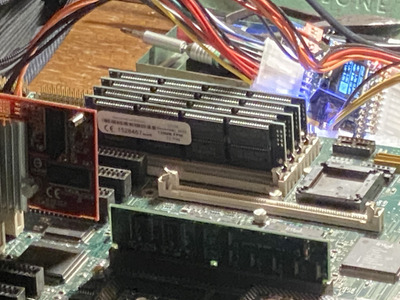

According to spec, i430NX does NOT support 128MB SIMMs - it supports max 256MB, but that's using a lot more than two SIMMs.
Hmm, something odd in the manual ( https://theretroweb.com/motherboard/manual/cm … 5e926995047.pdf ). Page 59 agrees with you and lists 32MB as the maximum per stick, but page 52 gives a 384MB maximum by using 6 @ 64MB. Also, RetroWeb's entry for the 82434NX ( https://theretroweb.com/chipsets/1357 ) gives 512MB as the maximum, using 128MB FPM. It also says the cache can be either async or pipelined burst. That seems to agree with the datasheet for the 82434NX ( https://datasheetspdf.com/pdf-file/45336/Inte … ation/82434NX/1 ). Datasheet actually says SIMMs of 16M x 36bit, which only makes 64MB, but I think that's for a single bank, so 2 banks (think that sometimes gets called double sided) would be 128MB. Looks like maybe the LX is only 32MB?
I might be misinterpreting something though, so please point out if I've gone wrong.

snufkin wrote on 2022-12-03, 21:52:
Interesting, that does look like 64Mb chips are supported by i430NX where they aren't in i430LX. If the 64Mb chips do work on NX I'd be very interested to see what they do on LX, as the chipsets are otherwise exceedingly similar. This sounds like i440LX officially only supporting 512MB SDRAM (yet 1GB of EDO) due to only supporting 64Mb chips, not 128Mb. Its successor i440BX supports 1GB of both. Guess what? Works on i440LX too. And i44oEX and i430TX too, albeit with 2 instead of 4 banks so 512MB max.

Datasheet says the LX has one less RAM address line, 11 (MA10:0] rather than 12 (MA11:0), so ends up as effectively 22 bits (4M addresses * 4 bytes = 16MB, at 2 ranks that's 32MB) rather than the NX 24 bits (16M addresses * 4 bytes = 64MB, 2 ranks gives 128MB).
Looking at the datasheet pinout then pin 109 is MA11 on the NX and is NC on the LX. Maybe it's the same silicon underneath but Intel didn't bond out to the package pin for the LX?

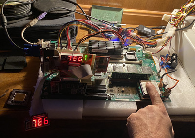

Reply 53 of 77, by Sphere478
The attachment 07C8EFD8-4E45-4F71-A625-108801FAAE71.jpeg is no longer available
So one thing someone told me once is that this board wouldn’t work on a non intel cpu.
Here is an attempt at a k6-3+ 570.
The bf pins aren’t set up on this interposer so that may be why. 🤔 gonna throw a k5 in there and see what happens
Result:
Sphere's PCB projects.

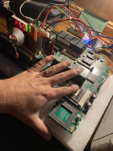

Reply 54 of 77, by Sphere478
Tried a tillamook. No dice.

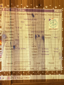

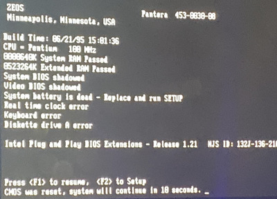

Finally succeeded with a pentium mmx 233 on the interposer. (Still set at 2.0v 🤣)
Bios says ‘pentium 120’
I think I may be dealing with some sort of Prejudice bios 🤣. Or a hopelessly out of date one, but why would a k5 133 not work?
It was making post codes… but no bios screen. So I’m thinking bf pins aren’t problem.
What alternative bios should I try? Mr bios?
Reply 55 of 77, by Sphere478
Tried a winchip.
Yeah, this bios is definitely doing this on purpose 🤣. Gonna have to hack it or ditch it.
I need my k6-3+ or I’ll start twitching and foaming at the mouth.
Edit:

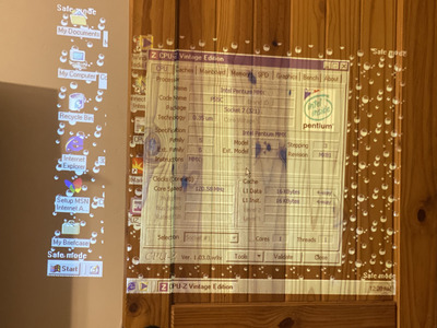

Finally made it to cpu-z (I’m keyboard only)
Crap, where’s my L2..

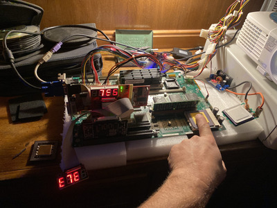

Reply 57 of 77, by Repo Man11

Nice work proving the memory capacity. I think entry level RAM around the time was 8 or 16MB. What does it do if you put those sticks you have in slots 5&6? For other possible BIOSes, might be worth checking https://theretroweb.com/bios/?chipsetId=273 . Other hardware on those boards might be different, so might lose IDE/Floppy/Serial.
On the POST codes, is the display E7 E6, with the missing digits in the photo just due to camera speed? A generic list of Phoenix codes says that could be RAM check. Might be worth trying going back to small amounts of RAM, and trying to work out which jumpers on the board control the cache options, so you can disable that for the moment.
