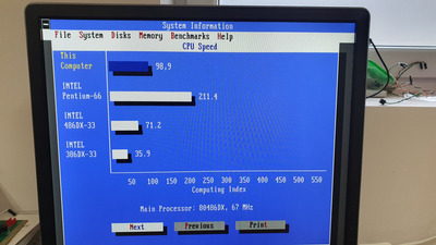

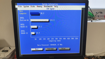

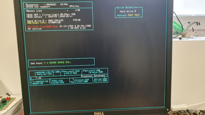

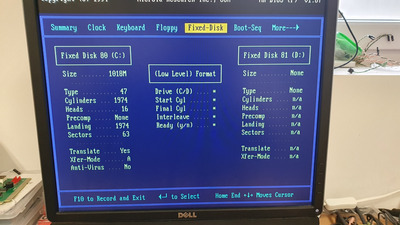

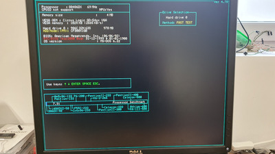

Is there a small performance gain over AMIBIOS?
Reply 22 of 33, by sonicx
Unfortunately, there is no performance gain. Only support for large disks has been added.

You should run a comparison of the speedsys memory tests.
