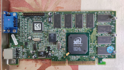

I got a voodoo 3 card today. When I opened the package, noted the capacitor C95 at the right most was broken (most likely due to mishandling by the customs here).

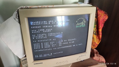

I then soldered the capacitor C95. Rechecked the solder and connections. They looked fine. On testing the card later (using Asus P2B), to my horror, the output was corrupted. Please see the below image:
79.98 KiB
1063 views
Please let me know if it is possible to fix the card (replacement of capacitors?) or the card is toast? Thanks.

This behavior is not related to capacitors. The usual cause is dead VRAM ICs / broken solder joints, but it can also be caused by a number of other problems (including a dead core).
Under normal conditions, the card should be repairable.

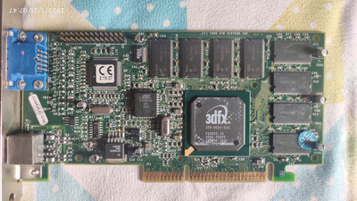

Hello pentiumspeed. I looked at the card's backside, but was unable to find any cuts on the tracks.
1.97 MiB
930 views

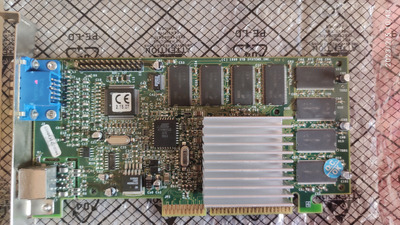

Also removed the heatsink and unable to notice any damages on the front side.
1.68 MiB
930 views
Tried searching for the video RAM for voodoo 3 on ebay with MT48LC1M16A1 (the VRAMs). I was indeed able to get some listings. However all of them are 7ns (-7 marking). Below is the link:
https://www.ebay.com/itm/393079896670?hash=it … ABk9SR8LZuPC8YQ
Let me know if this should work? Also is there any way to test which VRAMs are bad?
Intel 845GEBV2, Pentium 4 2.4 Ghz, Geforce FX5600 256MB, 512MB RAM, 160GB HDD, Sound Blaster Live! SB0100 - Win 98/XP

R65 appears to be missing on your card and R66 looks like it may need resoldering as well. They're right above the main chip. Try replacing/resoldering those before you replace your RAM chips.
I think both are 33Ohms but I don't currently have any V3 cards here to check myself.
Reply 6 of 15, by stealthjoe
Thanks for noticing that Doornkaat. Checked R66 and the number on that is 330 (33 ohm I guess). Any idea of the R65 resistor value?

Checked with another V3 card which was received today. The R65 value is indeed 33 ohms.

Hopefully. Let's see. Recently got the 33 ohm 0603 resistor and soldered it a few days back:

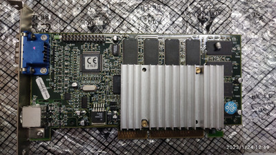

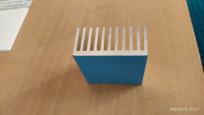

Next was anxiously awaiting the heatsink. The one ordered through ebay would probably take another couple of weeks. So got one locally with a thermal tape pre applied. This one is 40x40x20 mm (hopefully this should suffice for the card). Received it today. Planning to add a fan soon:
33.7 KiB
734 views
34.91 KiB
734 views
Then fixed it to the Voodoo 3 card:
1.46 MiB
734 views

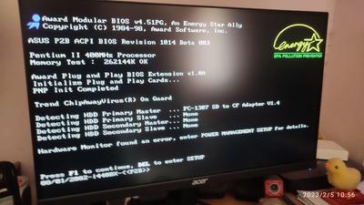

At last, proceeded to boot the system. Heart pounding. Fingers crossed🤞🤞
And finally!!!!!!!
91.76 KiB
734 views
Hooray!! The issue is finally fixed. No more distorted output.
Thank you so much Doornkaat!!!! 😀

I almost missed this post. Great success!😁👍 Glad it actually was that resistor and not broken VRAM.😃
Thank you for the update too!😎
