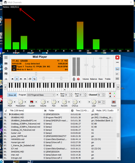

Does anyone know how to verify the polyphony on the MIDI files to verify whether the original SC-55 is capable of playing back all of the tracks without dropping any notes?

Unfortunately from a Midi file you can only determine the maximum simultaneous note polyphony but not the voice polyphony (and that is what matters here). Voice polyphony has meaning only in the context of a specific synth implementation.
Namely it is not defined in the Midi file if an instrument uses 1,2 or 4 voice layers or an instrument how long remains sustained after a note off message etc.
Here is a demonstration video about the problems of counting voice polyphony based on note polyphony (posted earlier in this same thread)
https://youtu.be/P6tqLA0V9u4
But maximum note polyphony information can still be somewhat useful since if the maximum note polyphony is high then the voice polyphony requirement is at least that much high. Namely if you find that a Midi file has a maximum simultaneous note polyphony of 29 notes then that Midi file is sure to be problematic even for an SC-55 mkII (that has a 28 max voice polyphony limitation).
You can see the maximum note polyphony during playback in my Midi player version 6.1.1 here:
(PS: make sure that you do not use Midi player in Bassmidi output mode since then it shows the exact voice polyphony data getting directly from Bassmidi)

That's very useful. Thank you.
