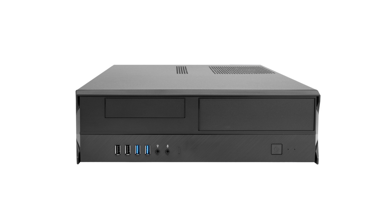

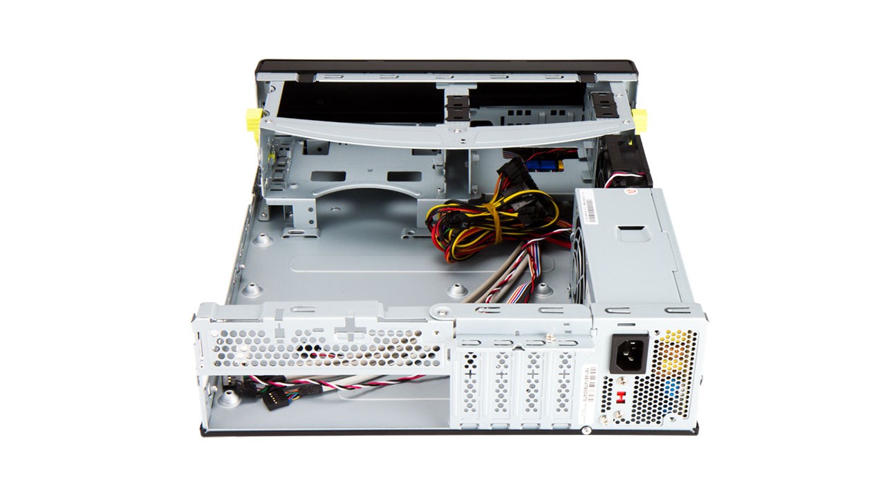

Reply 27 of 44, by RandomStranger
ultra wrote on 2023-02-15, 16:13:
What kind of custom builds? You can buy it somewhere?
I meant you custo build it yourself. There are very small cases, like the In Win BL series, which are small form factor cases allowing you to use standard uATX motherboards and TFX power supplies, have room 2×3.5" and 1×5.25" drives. You can get something like a Chaintech 6LTM2, a Celeron-A 333, a Geforce MX400, the low profile variant of the ESS AudioDrive ES1869FC and 128MB RAM and you have a fine and small Windows 98 PC for very cheap and just fast enough to cover the period most troublesome for modern PCs.
Components
I assume the ones with 8 RAM chips might still be 128bit
Also you can use any other more modern uATX Socket 370 or Socket A board for more CPU power, as long as you don't overload the 5V rail of your PSU. I don't think you can go much smaller while maintaining gaming performance and compatibility.
