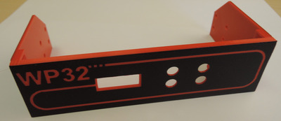

Is it possible to order McCake with this red 5.25" panel design?
Jura Tastatura wrote on 2022-06-03, 10:14:Is it possible to order McCake with this red 5.25" panel design?
Yes, send me pm to discuss the options

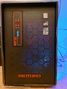

Got this bad boi today! Looks badass with this color combination (will fit perfectly my Riotoro case).
Can't wait to get home and start playing with it. 😁
Working as advertised and looking great.
Thanks Serge!
Jura Tastatura wrote on 2022-07-05, 19:48:Working as advertised and looking great.
Thanks Serge!
oooh that looks super great in that case !

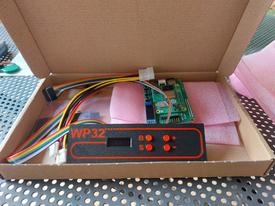

Hey, could someone provide some support with the McCake?
I installed mine on a YMF719E-S Yamaha soundcard. If I setup a game to use it as a midi device and then test it, it might work for a short while. But then it starts going crazy by playing random sounds all the time (it sounds like an orchestra warming up...), even while the PC is rebooting.
Am I doing something wrong? Is it broken? Or not compatible with this soundcard?
EDIT: I switched out the YAMAHA soundcard with another 719 model and now the McCake works just fine. So happy now. My comp needs 2 more fixes and I can finally call it complete 😀
