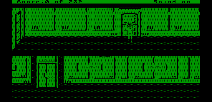

Hey everyone,

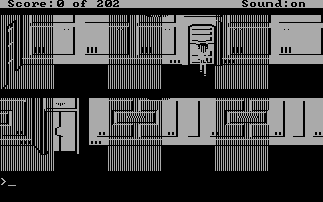

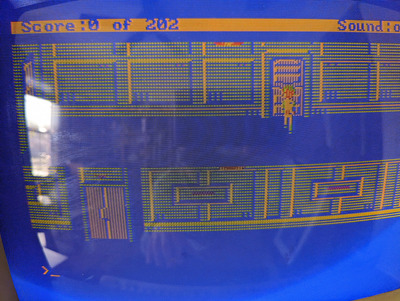

Not too long ago I acquired an IBM 5170 with a 5153 monitor.
My goal is to play the old sierra games in CGA mode, which is how I experienced them as a kid.
When I launch Space Quest this is what I get:
445.98 KiB
1155 views
664.03 KiB
1155 views

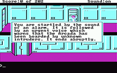

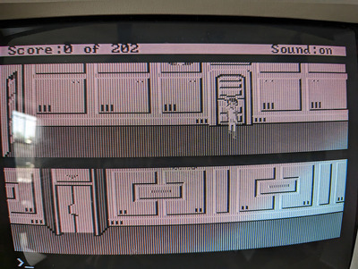

If it hit CTRL R I get it in color:
782.79 KiB
1155 views
This is definitely not how I remember CGA looking as a kid. I played this game a lot. The was limited colors but never the busy horizontal lines, Roger Wilco was very clear on the screen.
My big questions are: Why is it defaulting to Monochrome every time I run it? And why does the color image look so bad?

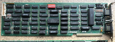

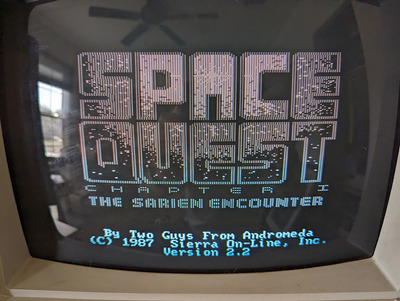

The system came with an STB Systems Graphix Plug II video card.
362.88 KiB
1155 views
I found the manual and the switch settings are set to 'color only'.
I also replaced the bios with an AMI to get support for a 3.5 floppy.
https://www.minuszerodegrees.net/bios/bios.htm#5170

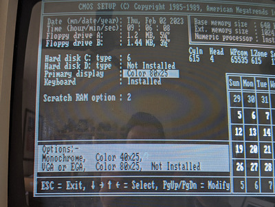

Here's the video settings in the CMOS setup.
607.13 KiB
1155 views
I'm aware of the 5170 having a switch on the motherboard for color of monochrome, I have it switched to color.

Reply 1 of 11, by Jo22
CGA can indeed be that ugly. It's "CGA RGB" graphics.
https://www.mobygames.com/game/114/space-ques … hots/dos/21864/
The monochrome thing is strange, though. Maybe a software issue.
I'm using Quadtel BIOS in emulation, btw. 😀

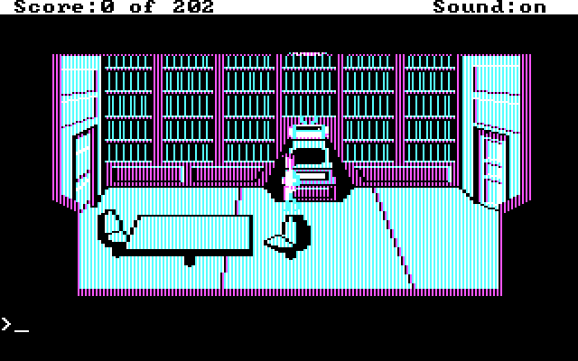

Edit: Now that I think of it.. Maybe Space Quest is using NTSC "artifact colors", which usually consists of a monochrome signal and special stripe patterns.
Just attach an NTSC TV via Cinch, err, RCA..
Reply 2 of 11, by Great Hierophant
There is nothing wrong with your game, your graphics card or your computer, it is your monitor that is lacking the proper functionality in this instance. You need a composite color monitor or TV, then run the game as plugged into the RCA jack on that video card and you will see color. Do not use Ctrl + R. Whether the color is correct or can be made correct may depend on that TV's tint control.

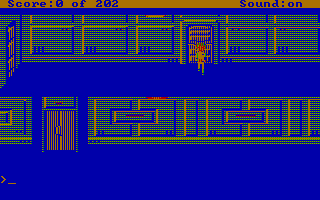

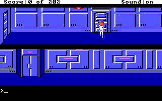

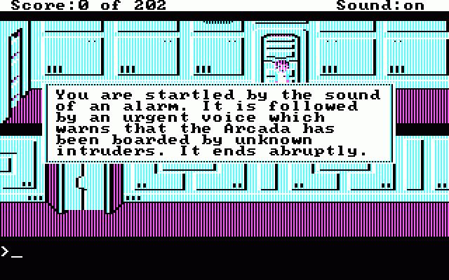

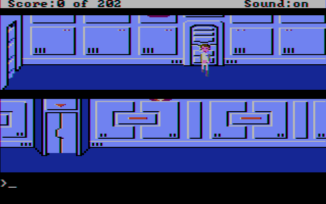

Early AGI Sierra games will try to autodetect your setup, but you can use override switches.
Like using SIERRA -T to force Tandy 3-Voice sound on systems without Tandy 1000 graphics.
Edit: I've attached pictures with the SIERRA -C override switch (DOSBox, S3 SVGA).
Maybe that's what you remembered back then.
Edit: The -C switch may also work the same with an EGA card.
The first image is the closest to what I remember, though I think the 4 colors used were different.

Reply 9 of 11, by Great Hierophant
Space Quest I and every other AGI game shows only two types of graphics with a real CGA card and an IBM 5153 :
This is the default presentation if you run the executable with no switches :
3.02 KiB
930 views
These graphics are only intended for composite color monitors and TVs, are wrong for a 5153 and on composite color displays they show colors like this :
4.84 KiB
930 views
This is the alternate CGA graphics display, which you can see if you run the executable with the -r command line option or hit Ctrl + R in game :
2.5 KiB
930 views
These graphics are intended for RGBI displays like the 5153 and the best a CGA card can do with an RGBI monitor.
Anything Jo22 showed using a light cyan/light magenta/white palette is EGA trying, and failing, to simulate CGA using the high-resolution composite color graphics mode.
These are the only graphics an EGA, Tandy, MCGA or VGA should show :
2.18 KiB
930 views
And finally, if you had a Hercules Graphics Card and an IBM 5151 display, you would see this :
4.25 KiB
930 views
Any other kind of graphics are wrong or not contemporaneous with the games. (Text fonts may vary depending on the system).
