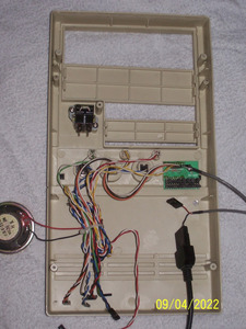

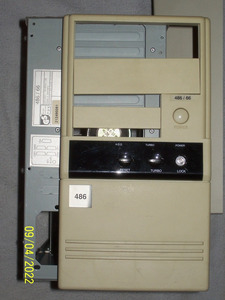

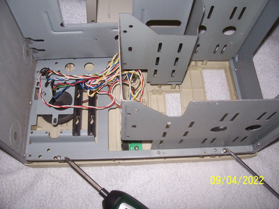

This beauty is the closest thing I own (not rare at all, it's bound to be in this thread earlier on. It says 486 and 66 all around since I got it, without content. The 66 was very long lived):
153.89 KiB
1798 views
324.94 KiB
1798 views
So, two screws on each side. Then take care the speaker's or other wires aren't entangled and none of the drives gets stuck when pulling it off.
Now, you'll have access and a view to solve the issue with a clear head:
206.71 KiB
1798 views
If you module is the same gk-568, this is your lucky day.
It's the type that does not have any direct connection to the mobo.
- first two cables on the left, white and yellow, power the single "Turbo" led besides it.
- second three, orange, black, white, are connected to the switch. And the switch has a parallel set of wires to inform the motherboard.
- last two headers are for a 5 V power, usually provided via a molex adapter to the PSU. They're marked, ground and +5V on the pin to the right.
I was able to confirm all that abusing a simple CD audio cable and an external HDD PSU.
All the other jumpers below are merely to define the display for each segment. So, this being two digits, there are 14 jumpers for each segment lighting up with turbo on, off, alway or not at all - in my case resulting in 66 and 8, respectively.
If your LED module is of a different type, make a clean photo, open up a thread, someone here will have the very same.

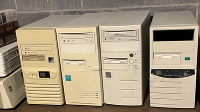

Going Left to right:
1) Pentium 133 on a VX mobo, guessing mid 1996
2) Pentium 166mmx on a VX mobo, guessing mid 1997
3) K6 166 on TX mobo, guessing late 1997. Case #2 and #3 are identical frames and both use those snap in foil like slot covers in the back. The differences are the face plates and #2 has a screwless spring clip latch on the mobo tray.
4) 486-66 on a Contaq based Lion Nice Green Mobo. The Bios was late 93, but the case seems a little newer. LCD CPU speed display only has 2 digits. Has strange bulges on the side like it is buttressed around the rubber feet. Guessing this was late a 1994 PCeven though the date on the 8x CD Acer rom drive was June 1996. The plastic front panel on the CD drive was so brittle that it pretty much shattered when I tried to open the case, so it isn't pictured here.

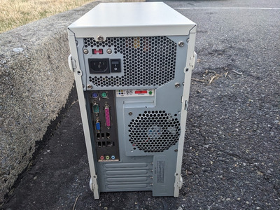

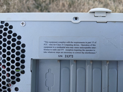

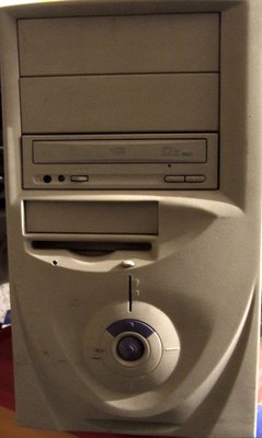

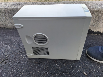

Trying to identify this case...it's got Inwin A500 vibes but it's clearly not an A500, so I don't know if it's a different Inwin case or some kind of Taiwanese clone.
279.01 KiB
1079 views
333.58 KiB
1079 views
403.31 KiB
1079 views
161.94 KiB
1079 views
Reply 179 of 227, by S500collector
Looks like the Inwin V500 T matx case, very good case . I still own several inwin S500 atx cases. The “T” refers to intels T.A.C case ventilation solutions.
