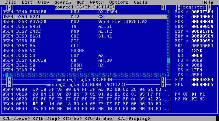

But my version ran correctly even when I disabled the CPU's internal cache, while yours didn't, if I read your posts correctly. So the original issue wasn't solved, was it?
jwt27 wrote:
How do you even find these fixes?
Ran the game in Microsoft CodeView; instead of bailing to DOS upon encountering the divide error, it will pause and highlight the offending machine instruction (see screenshot). You can see that to the left of the offending DIV instruction are the two bytes (F7 F1) that make up its machine code. I then searched for those two bytes in LOTUS.EXE. Finding nothing but noticing that LOTUS.EXE is extremely small, I expected that the main program code would be in LOTUS.DAT instead. Finding several instances of F7 F1 there, I took the last byte from the preceding instruction (FB) to search for the three-byte sequence FB F7 F1. Since this occurs only once in LOTUS.DAT, I knew that this would be the correct position. Now you only need to know that opcode 90 is NOP ("no operation"), so disabling the DIV instruction to avoid the divide error is as simple as replacing F7 F1 with two NOPs.
(I suppose the real hackers would be laughing their asses off if they saw that I'm using Microsoft CodeView instead of some leet debugger tool.)
jwt27 wrote:
Is it the same bug as the well known Borland runtime error 200 that happens with certain other games?
I suppose so. It definitely looks like a system speed-specific calibration of some kind of Delay() library routine that does not seem to be used by the game itself.

The gist of the problem is to change FB F7 F1 to FB 90 90 in LOTUS.DAT file. Specifically, you want to look for:
- address 0xAE86, where you'll just find F7 F1 to be changed to 90 90, IF your game version is 14/07/93
