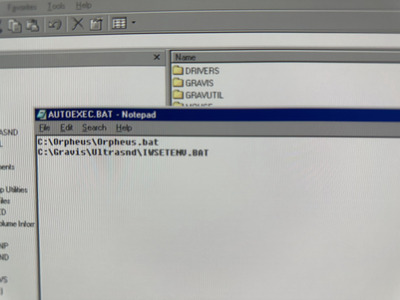

Running through the setup of my Orpheus II in Windows 98 but have some questions... Are we supposed to install the Windows 95 Plug and Play drivers, I assume so as they really are the only ones that would work in Windows 98. That said, it does install the ULTRASND Directory in the C:\ drive. But you also have your own version of ULTRASND for DOS and in turn DOS in Windows Mode. Should we not use the ones it installs I am guessing? So in the autoexec.bat, just point to the folder I copy from Orpheus?
So far I have been able to get GUS sound effects to work in Windows DOS Mode, but having some issues getting music to work. Been trying with Duke3D first.
There is only one driver for all win9x versions - the win95 v2.2 one
Ideally you should let the windows driver install it's stuff to where it wants and also mount the PnP CD , run it and let it install stuff too so that you will have a good working win9x and DOS-in-9x environments.
The "DOS: Gravis UltraSound PnP PREINSTALLED driver" is meant to be used under pure DOS , not a DOS-in-9x environment.
You might be able to merge both DOS portions if resources remain the same but in any case for a proper working win9x environment you need to use the gravis 2.2 driver + CD

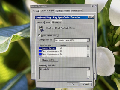

Reply 284 of 1273, by KuroHouou
Kahenraz wrote on 2023-03-14, 23:06:
That's usually a sign that the IRQ and DMA isn't setup right for the card in Device Manager.
So in Windows it defaults to installing my GUS device on irq 11 so I have to go in and change it to 7 manually.
Before the change, the game says the IRQ needs to be 7 or less
After the change that's when it says the device can't be found anymore.
I noticed the iw.ini updated though after the change so its reflecting IRQ1=7 like it should
The rest of the settings that I think matter there are...
DMA1=5
DMA2=7
IRQ1=7
IRQ2=0
I don't quite know what IRQ2 would be for?? But the DMA's are right according to what I see in Windows anyways.

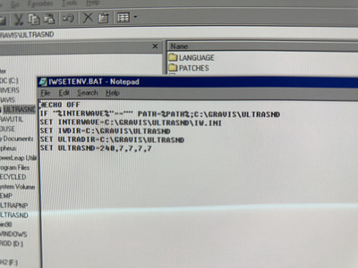

Also IWSETENV.bAT is setup with the following
SET ULTRASND =240,7,5,7,7
Side note, it has
SET BLASTER=
can I delete that?

Just to post the official Documentation on this bit of info..
"It is best to completely ignore SETUP.EXE that attempts to allocate and test
resources for the GUS PnP Interwave chip, the program is just too buggy and
unstable (this behavior is irrelevant to OrpheusII , the same applies to
the original Gravis UltraSound PnP cards).
By default the Interwave chip in this package is configured to use:
Port: 240
DMA: 7
IRQ: 7
Record/Playback share the same DMA/IRQ - not only to save 2 resources but
also because the InterWave is a playback-only device on the OrpheusII.
Sound inputs, Joystick, recording, SoundBlaster, MPU-401, OPL3 all are
handled by the CS-4237/PCMIDI portions of the card and the InterWave portion
only handles the Gravis UltraSound stuff (much like Gravis did with their
Gravis UltraSound Extreme card). Because of that files related to such
emulations have been removed from this package as there is no need to have
InterWave attempting to emulate a SoundBlaster or a MPU-401 interface."
Only thing is, Windows assigns two DMA's to the GUS device, 5 and 7.. Maybe I disable one??

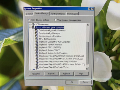

Hello!
SB Bits/Joystick/CDROM are disabled on gus part.
If you have trouble go to control panel, devices, then configure Crystal part to 220 I5 D1 and when you install gravis part you will see Things disabled. (See pictures on first post of this thread) Try to set gravis part to 240 I7 D7 H7.
Also on PCMIDI you must use 330 I2/9
Reply 294 of 1273, by Marmes
You should use 2 DMAs High and low DMA you can set to 7 both or 7 and 6 for example.

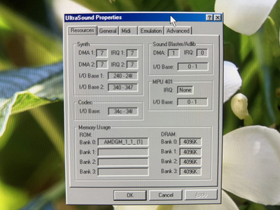

I have Windows set to DMA 7 for high and low and IRQ set to 7 as well. So it should all be 240 I7 D7 H7. My Crystal SB should be 220 I5 D1 D5, at least that's what it has always been. But right now I have two issues.
1. Music doesn't work from the GUS, I hear a little pop like it should start playing the music but then nothing plays
2. Sound Effects no longer work when set to Sound Blaster, says their is a conflict now.
3. I am getting an error when orphinit runs saying unable to reset soundblaster dsp, probably related to 2.
I am attaching some more screen shots from my setup

Reply 297 of 1273, by KuroHouou
Marmes wrote on 2023-03-15, 01:12:
D5 is not ok it should be D3 , there is no DMA5 on crystal part. Only 0, 1, 3
For the Sound Blaster you mean? DMA 3 and DMA 1 should be used? Actually I got the SB working again, although still see that error from Orphinit... My SB Audigy was trying to take IRQ 5 so I had to reserve it in the bios.
