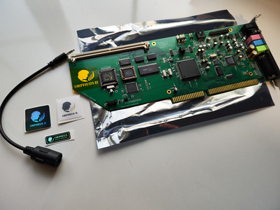

Reply 318 of 1290, by NinjaWarrior
Cheers!!! My Orpheus II has arrived!! I installed it, configured the BIOS accordingly, and it is working like a charm!
Thank you Marmes & Keropi, and 640K!enough of course 😁
P.S. What a nice surprise when I saw the 3 stickers, this is indeed a PRO product!
The attachment orpheusII_ninjawarrior.png is no longer available
The attachment orpheusII_ninjawarrior_2.png is no longer available
The attachment orpheusII_ninjawarrior_3.png is no longer available

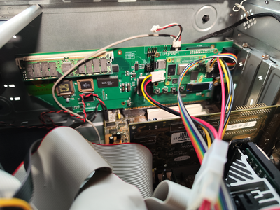

Reply 319 of 1290, by Stevogamer
NinjaWarrior wrote on 2023-03-17, 19:51:
Cheers!!! My Orpheus II has arrived!! I installed it, configured the BIOS accordingly, and it is working like a charm! […]
Ooh is that a MT-32-Pi I see mounted on there
