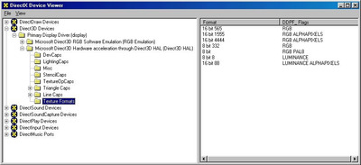

As I've said before, setting "8-bit textures" to "yes" in Quake 2 makes the engine use GL_EXT_shared_texture_palette which, in term, calls GL_EXT_paletted_texture. This can be easily verified by pulling down the console and checking the output on a graphics card which supports paletted textures in hardware.
Is there also a Direct3D equivalent feature that isn't supported on these cards?
There is, but it isn't documented as well as the OpenGL extension. It is known that games like Driver and Final Fantasy 8 use paletted textures in Direct3D. This is evident from their documentation and/or config files. See screenshot below.
file.php?id=123649&mode=view
Also, it appears that Microsoft's dxview.exe sees the capability of graphics cards to support paletted textures in hardware as 8bit RBG PAL8.
Thanks for the explanation.

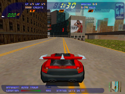

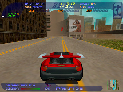

Reply 422 of 553, by Joseph_Joestar
I tested Carmageddon 2 and Need for Speed 3 today, and I noticed something interesting. Both of these games seem to render fog in Glide mode, but don't have it in D3D mode (regardless of graphics card used). Here are a few screenshots:
119.93 KiB
2618 views
107.85 KiB
2618 views
Note that both of these screenshots were taken on the exact same graphics card - a 3DFX Voodoo 3. And yet, the fog only renders in Glide mode, but not in D3D. I also tried Carmageddon 2 on Nvidia and ATi cards and the fog didn't render on those either, as they only support D3D of course. Additionally, the skybox appears to have a bit more detail in Glide mode.
94.06 KiB
2618 views
88.6 KiB
2618 views
Need for Speed 3 is even more weird. It renders fog only if the Banshee patch is applied, but not if the Voodoo 3 patch is used. Of course, it doesn't render any fog on Nvidia or ATi cards in D3D mode. For reference, I found these instructions which allowed me to use the Banshee patch on my Voodoo 3. Based on the info in that thread, the fog does render correctly on Voodoo 1 and Voodoo 2 cards as well.
In summary, I think both of these games use table fog, but appear to do so only in Glide mode for some reason. So my question is, has anyone seen the fog render in NFS3 and Carmageddon 2 outside of Glide mode? Obviously, I'm talking about the retail CD releases of these games, with only the official patches applied. And without using any fan-made mods or fixes.

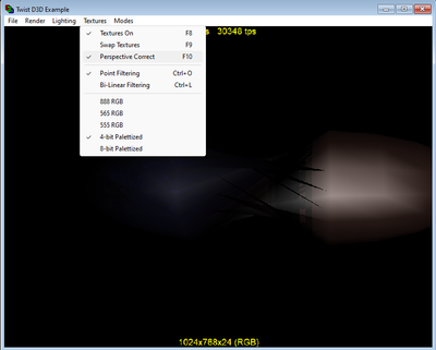

Reply 434 of 553, by BEEN_Nath_58
A little bit off-topic, I never heard about 4-bit palettized textures until I saw this:
file.php?mode=view&id=154831
More details on this?
Reply 435 of 553, by BEEN_Nath_58
Turns out my Win7 Intel HD machine has RGB PAL 8 as well as RGB PAL 4 cap. The 5900XT in comparision has only RGB PAL 8. So which was the earliest card to have supported 4 bit palettized textures?
Also there is DD Palette Caps section in DxView, however the demo in my previous posts queried for DDPCAPS_4BIT as well as DDPCAPS_8BIT, which is not available on my hardware. I am curious how this demo turns out on 5900XT, since my modern Nvidia also doesn't support both textures but manage to run it.
I am certainly not sure how Texture Caps and Palette Caps differ the visual quality.
There is also 1Bit and 2Bit Palette caps, and I haven't encountered an app using them.

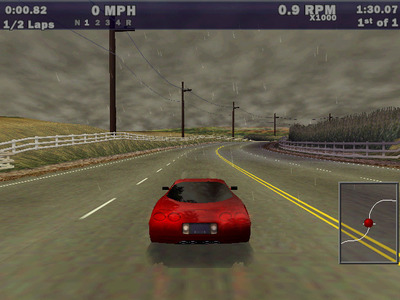

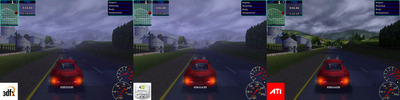

Reply 439 of 553, by Joseph_Joestar

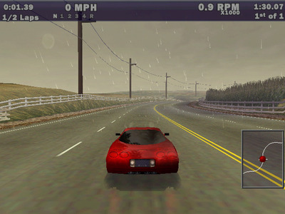

I finally added the full version of Need for Speed 4: High Stakes to my physical game collection, so I did some more table fog testing. Note that the NFS4 tagline is "Road Challenge" in the UK rather than "High Stakes", but it's the same game nonetheless. In the full version, it's much easier to line up comparison screenshots with the fog effect, than it was in the demo. For testing purposes, both "Weather" and "Fog" must be set to "On" in the game options and track settings. FYI, the track "Celtic Ruins" makes heavy use of table fog, and that's where my screenshots are from.
Graphics cards tested:
  • 3DFX Voodoo3 2000, using 3DFX reference drivers version 1.07.00
  • Nvidia GeForce FX 5900XT using Nvidia reference drivers version 56.64
  • ATi Radeon 9250 using ATi Catalyst reference drivers version 6.2
Games tested:
  • Need For Speed 4: High Stakes + latest official patch 4.50
Need For Speed 4: High Stakes (Celtic Ruins track)
247.22 KiB
1529 views
It's easy to spot the missing fog effect on the Radeon card, while both the Voodoo 3 and the GeForce FX display it correctly. From what I've seen, this game makes much more use of table fog than its predecessors.
