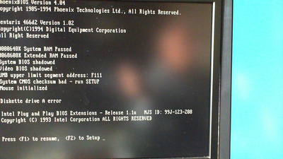

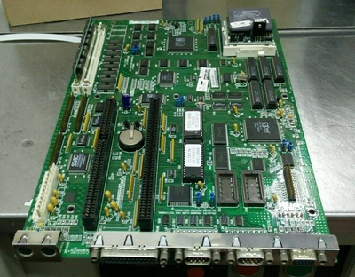

I kept feeling I should have an i486 system, wanted one with PS/2 Keyboard +Mouse and in the end decided on a Digital Venturis 466.
Looking in the manual it does not seem to specify the PSU pinout, to me it looks like standard AT, can anyone confirm it is please?

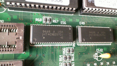

I assume I can add two more Video DRAM chips, again the manual does not specify what they are, if you know then it would be handy to know so I can order them before the board arrives.

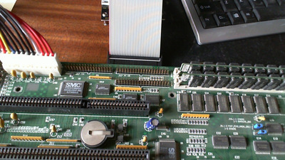

The board has arrived and it turns out that the power is standard AT and the system posted OK.
file.php?id=160596
The VGA DRAM chips are MT4C16257DJ-6 which are listed on eBay UK, but the guy only had one left 🙁
What is the recommended way to connect an IDE cable? All 40 pins are present so all the cables I have as they expect one pin to be missing. I drilled a hole in the connector and that did the trick 😀

Reply 2 of 19, by bogdanpaulb
For videocard ram (dram type) you should be able to use any chips that are similar from a donor/dead vlb/pci video card . S3/S3 trio/S3DX/Cirrus Logic/Opti/Ati , even if they are from another manufacturer (the ones you have are from Micron) . The only things that are recommended : insert them in to the socket correctly (mind the key) and mach the speed (-6).
Reply 3 of 19, by Vynix
For the IDE cable, you need to plug it in so the key tab matches the indent on the silkscreen, if not, there ought to be a indication where pin 1 is (at least that's how it is on my Shuttle board).
Reply 4 of 19, by red-ray
red-ray wrote on 2023-03-23, 15:29:
Vynix wrote on 2023-03-23, 21:26:
Thank you, but it would not plug in at all, however I have drilled a hole in the connector and thus far managed to install Windows NT 4.00 SP1 😀

The vram is FPM and still available on ebay. I used part number without speed.

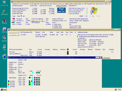

I've been allays curious if the video dram will work in pairs of 2 FPM and 2 EDO , like the normal ram works mixed in pairs . The specs of the s3 chip states that supports both FPM and EDO.
Reply 8 of 19, by red-ray
bogdanpaulb wrote on 2023-03-24, 01:30:
Will video dram will work in pairs of 2 FPM and 2 EDO , like the normal ram works mixed in pairs .
With system memory this depends on the chipset. I had a 440FX system with mixed EDO + FPM, but suspect many chipsets don't allow both at the same time. I don't recall ever seeing a GPU with FPM + EDO at the same time.
I now have 2MB on video ram, I repurposed two chips from another VGA card, and plan to keep an eye out for some cheap (including postage) ones on eBay.
SIV 5.70 Beta-01 now does rather better on my DEC Venturis. The DE200 is now working which makes life much easier as I can just copy files across the network and use the MSVC 6 remote debugger 😀
file.php?id=160766

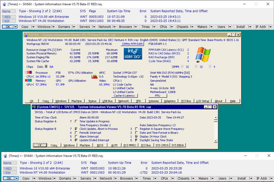

I seem to have an issue with the CMOS date/time. When I power down the system the time stops incrementing.
file.php?id=160790
Before I powered down the time was correct and the CMOS time was updating. After powering off the system for around 1752 seconds the CMOS time was out by 1752 seconds.
Has anyone seen this happen on other systems and/or know how to fix it please?
My current work around if to automatically do NET TIME /SET /Y \\RED to get the correct time from my main system.

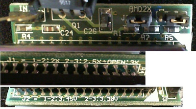

I feel I would like a less slow CPU and am unsure what my options are. At the moment I have as below and expect the board drops the 5.0 volts to 3.0 volts, but the jumpers don't seem to offer 3.0 Volts, then again https://en.wikichip.org/wiki/amd/am486/am486dx2-66nv8t specifies Vcore 3.3 V ± 0.3 V. On the side it says:
J1 = 1-2 : 2x 2-3 : 2.5x Open : 3x
J2 = 1-2 : 3.45 V 2-3 : 3.30 V
J3 = no information - I suspect the J2 settings are actually the J3 settings, but if so what does J2 do?
I suspect a Cyrix 5x86 GP100 will be the most cost effective upgrade as 133 MHz CPUs seem rather pricey, further there are no 4x jumper settings.
What do you guys think please?
file.php?id=160821file.php?id=160824

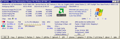

Reply 14 of 19, by bogdanpaulb
J2 should be 2x multiplier for AMD cpu's (it's marked with AMD 2X), because i see that J1 is marked with 'Intel' and unpopulated so if that was the only multiplier jumper, the CPU should be running at 3x33 Mhz and i see in the pic that it's running at 66 Mhz.
Reply 15 of 19, by red-ray
bogdanpaulb wrote on 2023-03-26, 18:48:
The CPU should be running at 3x33 Mhz and i see in the pic that it's running at 66 Mhz.
No, an Intel CPU would run at 3x, I currently only have the AMD which should and does run at 2 x 33 = 66 MHz.

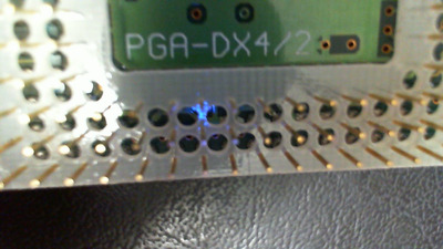

I just found Unknown PGA DX4/2 Interposer which looks identical to the interposer I have. I think it will work with a Cyrix 5x86 GP100, but am wondering "will the BIOS support the Cyrix ?".

    PGA-DX4/2 that I have

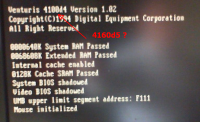

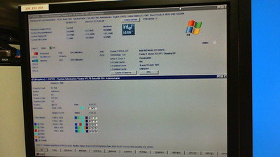

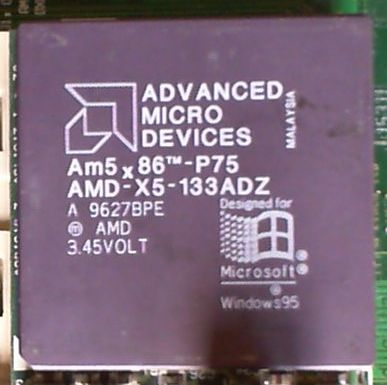

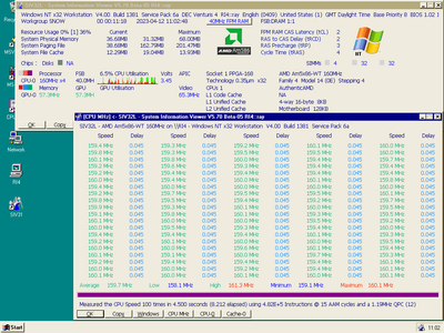

I just got an AMD-X5-133ADZ and was concerned when the BIOS reported it as 100 when the system posted, is it common for BIOS of this era to report unexpectedly?
I also tried it @ 160 MHz with the same being reported.
Once Windows was running I was relieved to see the speed was what I expected. How much am I pushing things by running it @ 160 MHz, is there any downsize I should consider?
file.php?id=162146
Reply 19 of 19, by pentiumspeed
Careful of this motherboard this contains a CMD possibly 640 which is a issue with IDE reliability.
